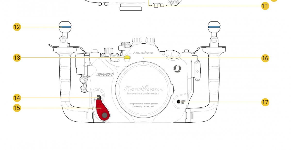

  1. On my Nauticam housing for Sony A7R5, I find a light transmissive window that I did not encounter so far on my previous housings ("13: AF Illuminator / Visible light sensor"):
    Does somebody know whether and how this new feature is useful for UW-photography (AF illumination (usually I switch this off)? or light sensor for WB?)?
    Thanks, Wolfgang
    Edited by Architeuthis
  2. I wondered the same when I saw this on my A1
    Any time you use a flat port longer than 45mm the AF beam hits the port so this is useless and better set the camera to disable it
    No idea why Nauticam spent the time and energy for this feature in the housing
  3. I asked st Nauticam US. Phil Burghard responded that "I believe that same light illuminates red when recording so it gets used a tally light". He will test it out when they have their camera back, that is out of office, at present...
    Wolfgang
    Wolfgang
    I do not need this feature as the LCD and EVF itself have a nice red circle when the camera records a video
