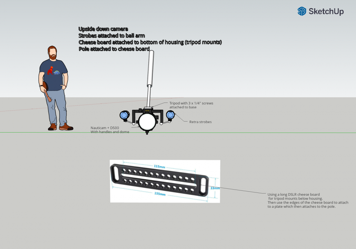

  1. I've been thinking about a remote pole cam, but one that is as easy to make as possible. As I'll be using it with my large dome for splits (for now) i suspect it'll be quite buoyant.
    My idea is to use my existing tripod, mounted at the bottom of the camera. And somehow connect the 3 balls to a fixing, which would be at the end of a pole. Not sure what this fixing would be yet.
    In addition there would be some padding at the "top" of the camera (now bottom) to prevent damage from it being dropped, but also to protect the fiber optics and strobes.
    Lastly there would be a remote mechanical trigger of sorts, but I do think to begin with I'll use Nikon's very unreliable snapbridge live view to get going.
    I've yet to see a mechanical trigger (if you know of one that is an easy fix or easy DIY I'm all ears!). I did read on people's recommendations for bike brakes, which is a neat idea.
    I'd love to hear about your opinions on a set up like this, and if you think the tripod mount and connector is viable, given the weight of a D500 + strobes.
    Thanks!

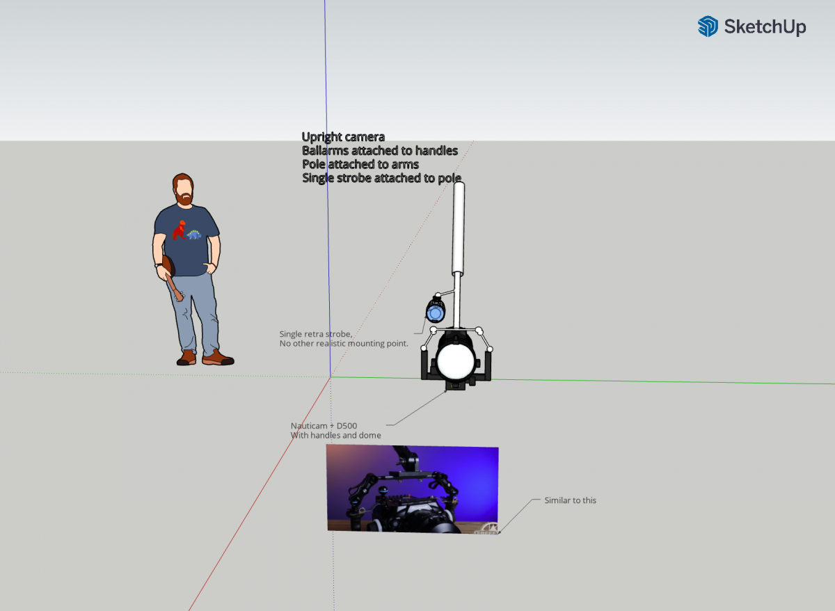

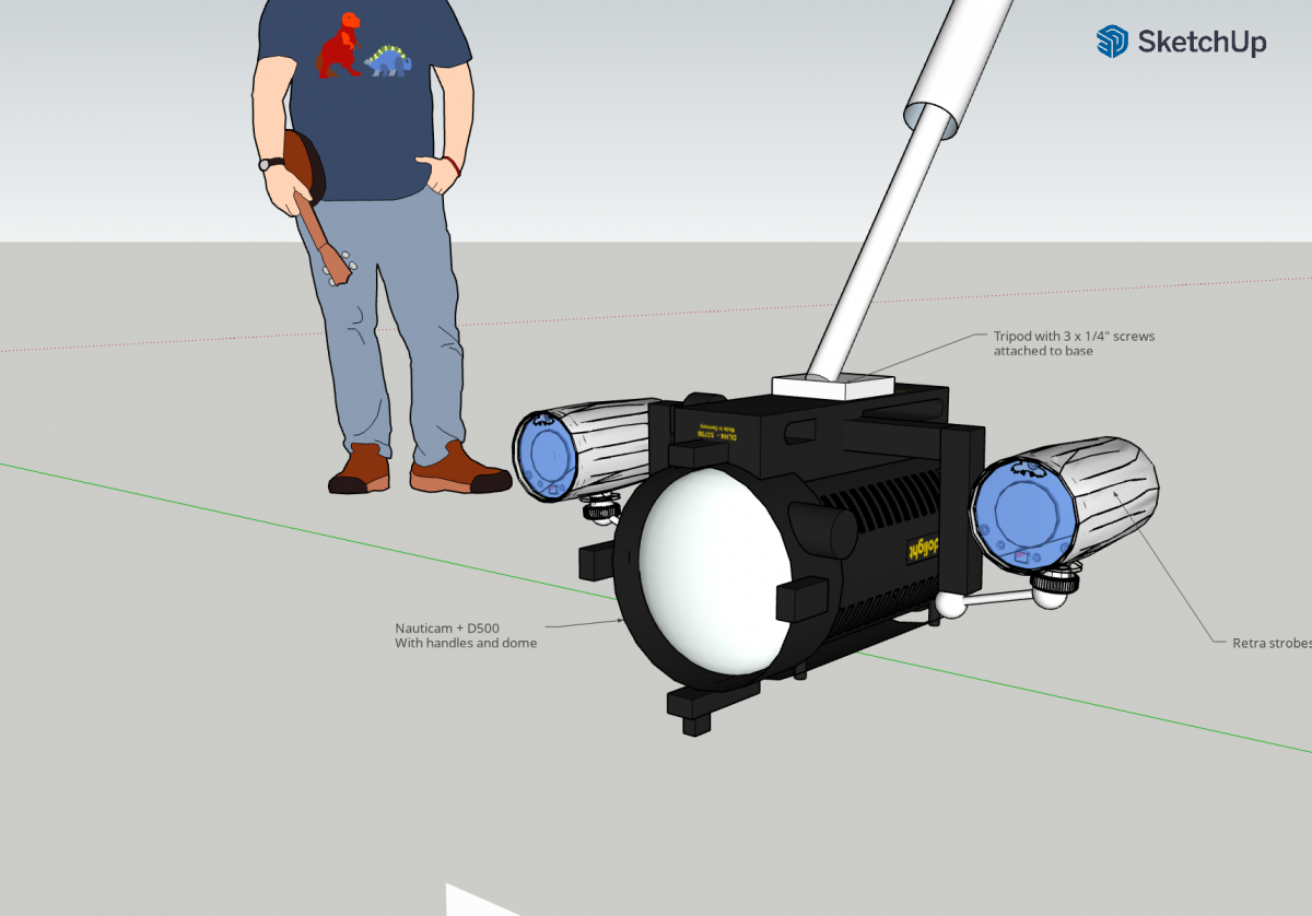

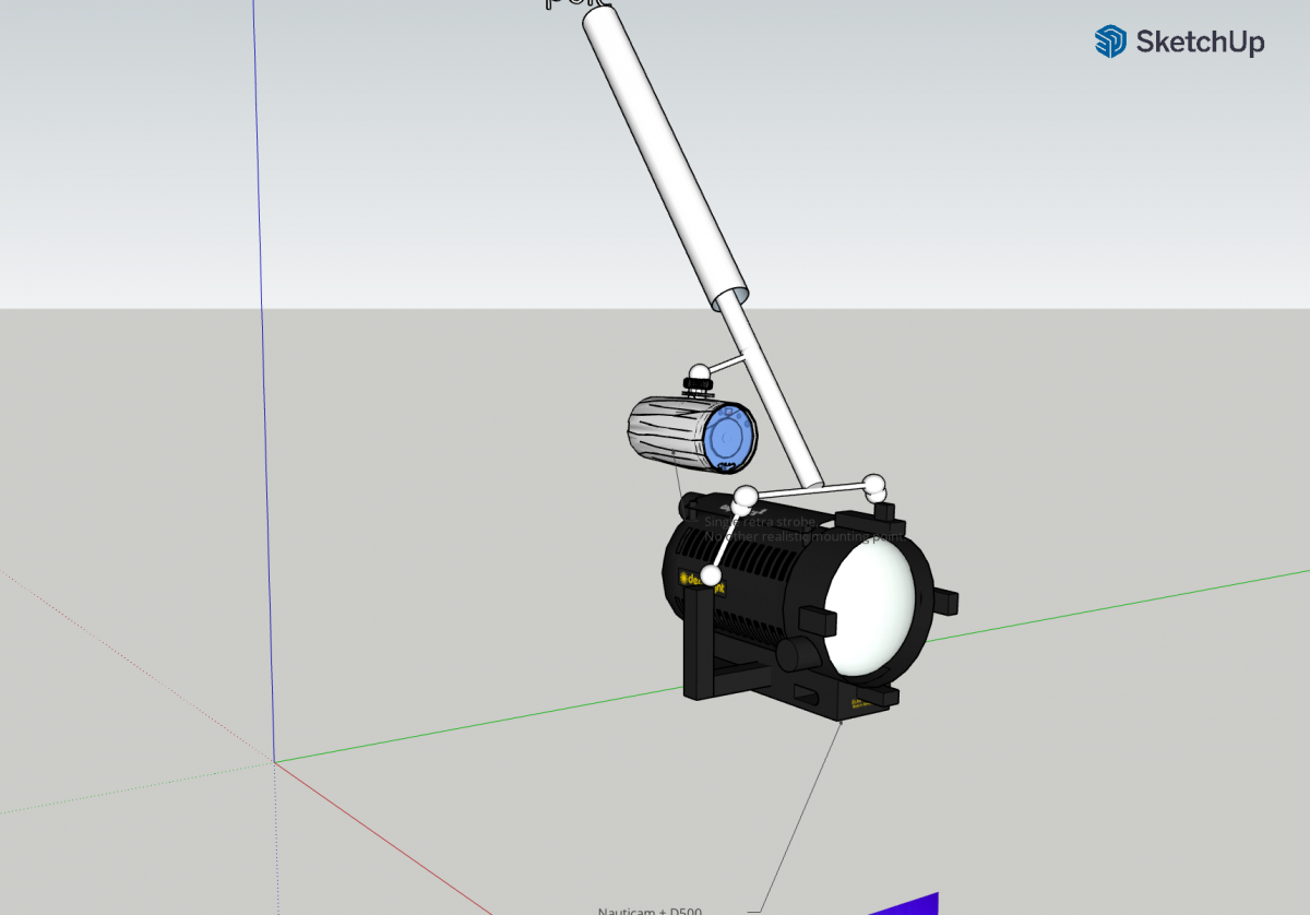

  2. Here are a few preliminary designs. Sorry, you need to use your imagination somewhat. Assume the thing that looks like a theatre spotlight, is a DSLR housing :)
    UPRIGHT design with single strobe, connecting to the handles of the housing
    UPSIDE DOWN design with two strobes, connecting to the tripod base of the housing (where you have 3 1/4" screws)
    If anyone can please provide advice on:
    * What type of pole has worked in both fresh and salt water? I presume the answer is "one that isn't extendable, or one that is permanently extended"?
    * How to connect the pole to an anchor point? My main concern here is one of weight. A single anchor point to a housing with 2 strobes feels like a weak spot. This rotatable PA mount seems like an absolute *perfect* fit, but again, I would be concerned about a single screw holding up a heavy load.
    * How to trigger these reliably. I did read about brakes for bikes, perhaps this is the best way?

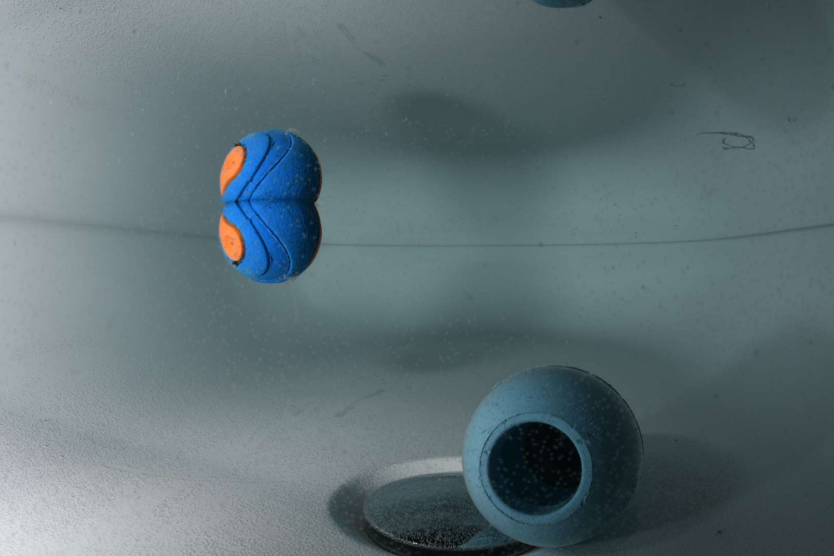

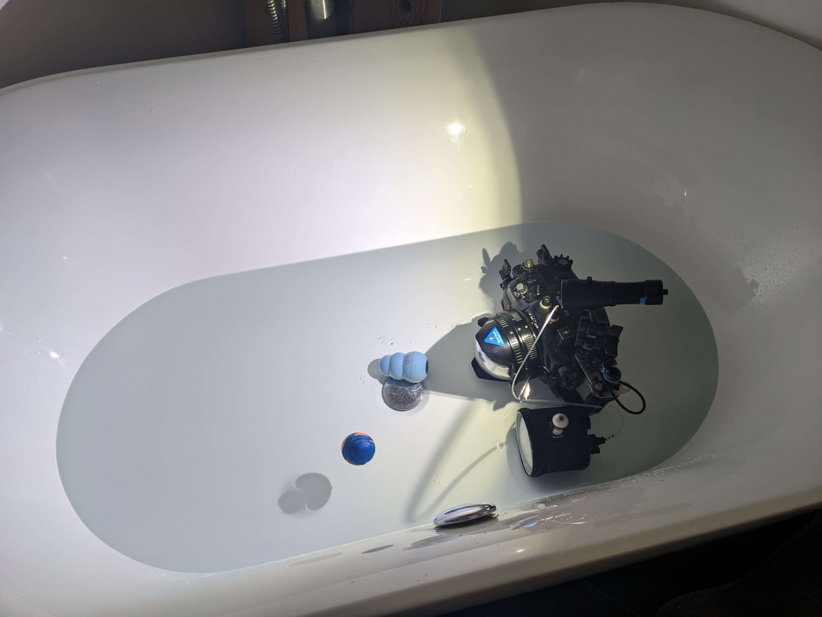

  6. Hey folks, I did some prelimiinary tests, and they worked. Although liveview is slow, it's good enough for more static shots.
    Here it is in the bathtub connected via wifi and me shooting from outside of the bathroom, and here is the liveview result (low res). This will do until I come up with the brake lever trigger actuation which Alex Mustard pointed out.

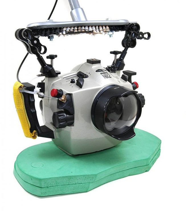

  9. @Tom_Kline I've done further testing, and I've realised that I am overcomplicating my set up. I think I'll be following a similar approach to Alex Mustard, here's his picture. The beauty of this style set up, is that you don't actually need an adjustable bracket, you can simply twist the top horizontal arm, and tighten the clamps (sure it's won't be 110% stuck in place, but an approximation is good enough).
    I've found the best way to do this is to actually just use my long ULCS clamps, attach them to the ball mounts on the housing (x2), and then have a horizontal arm with 1" balls either end (first picture is inaccurate, I connected them to the outer mounts, rather than the inner mounts).
    AJFCJaUKYiPME8B1VRaf1TyWAZ_0ho7FcWRNSJKv6N4wd9PNckXuwe_Vt1YAgjyGaGEKiDi4HBrp7n9P9UM4PMgISy3ZKJWe6q2x2-5vtGIhcEVU_H4OLSI3E18TEyPV1xL7Zfb6x9gt2CvvkLTRIeABDuu_Vo7JH9ZCQH2SuZyRbOXMGKj0OyhyCImtK5xqwMo9EnfCb9dut5AZcrfmT5nbqIdIfHFFBxcdWCFtah3dGeXOSuV_wOZ2m82KARoNs1UqVLEmq0QysPVURZKHjkfbl8-MP-gPJSa8DhTE41Vo6IZmApnnm_fjAFufljid1TiLpqKpDqW5TzZpeTUIm82pWzmgIT92Tll34xCeuR2Uzf7o1hEY8GVt_Z3_P7QgdqxV2ycTs98WOhl4cf7zXDJV1FYwcEARm0slFgNrIJaDEcQuyxKE0QMfHLtN-BlxWZ0E-sfWXPWh1ejRpRvD8KAWrRhIX6Tc3qnM6X6118RMw6iu_1xbkTfGAgMFue6MNdYqAPgoTGmaKRap5eRocPscIcV22MWVlm1ybJiHYVSz09TzWAVQsPJn7MYOy03jatfA6ZU8W7gG7T57vL4hluBZ2tI0zd2JAAtoS9mGos9ukMhtM2o4gu6QVW9tvgQHbQXZ6ITJeQlEMr0Np6DSPrXJY1qT01AnvFYVy9Co5edCiYWmNG_KdHKmZo5eh48oGqlIZvqF2ECo_y4B5HjEi5v81rsqba5noKdr5x-iQz8rl0fqh9EYRF0iyIaAj5_gZTvAxmPnvohNQoKtMBWlW2KGeSKtEzPhkpJ-wSd-P4QbErL2nYXx4N2IRCWBkwyD9hLH_PKLvSmxbnClPEcSPrHosNJyY0lw5Ob4HeZctiHF6tYuYObtbo_gpdqBlqkkOfysEgKLwuV7KgH-YVvNWUs9Jsg=w1720-h1290-s-no?authuser=0AJFCJaWuzLIjMubJO1-Y0ydmcD5AMI1wjetof-X9F1lBceobOyVFdgMMgni0ySKpBH2oDT_lmmsGkjK7bbHupcQsRbt1_Tfs6fZvYQFoOLug6n3tTpsJkLi2oagiznPGnus-rcL8NdP2IgeFo_AGeoik5OCaoDvdZXZL3zhQ4v78bpgzUjJi5LXLWX1LWTSl6Z2pZnJ908zHwKCc5QwJxXiTS3XaAnzex8hipj34pT7X1fvDfBqqJ8OGQGnYjpORGGnnRfWnRLOLbb4Ra0EP_KG1klpnZzWTyA0HDywPUS0t4fwpfuNZg-4Sx-qxBbD2q0Ux-PM8xmEIgNIhgr8O4qf7RwuPE4qXYkfOeTQnPDy3VpbvNIafh_wY7X1NciTKREvFMW6ofuxXbKvIvjoR01nHOkNIIBzQE05477h3bgR_xScumHqf_Ov5pGeLrD-bbJAtb4hJbdAaPVgjTdF_09hwfUlmqHbLBfSAxaR-Ahoqe9VZ5CeODJEjcgkvF6fGiyV7h2AjaGxbPcnZpjUXOYQCjdbSjNFV7xNIHnHU7fzPtbno81twPkEnLdXe9bAHgeahpMdb6sSmC4dJtYg4W4R4Gj2CvSoZn-1cY1BkLr3GlkWrOX6RWL-JF0mUamX6CswhgqxFuC9B9Zk3gMmCMqPq2gPFqHQ2BUAB0XJzudJeKPYGexb3voHuKH7AvA4PfUhobNXsYLEZ-nruudF_TtwmG3OCSrjfOc9IjwVyxZsVmu0JldLKGO91tSbvwB219E53aqkK4hthGFyNwA1UIO3EoWxvAIWTrAKl2rSEJg-WeJ9DkS_4jYBUlgyGZl7U3Ux8BGuNirK-2ufGlUEgSoKg_IbJsPh8V6NbYcts-59msEbEP2Op9D7zZSRqNhnCuCltWHhv62Lr0_Ee9KwxecA8dWY=w1004-h1338-s-no?authuser=0
    As you can see, it frees up the arms, and I can attach strobes either end. But there is no easy way to mount a pole to that bracket, it's a complete non standard size. This made me think, that I can have a setup like I initially proposed:
    Essentially, I want an aluminium pole, with the ability to screw in, or secure an arm with 1" balls at the end, and perhaps a way to secure another 1" mounting point on the pole for an "above water" strobe.
