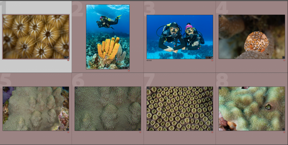

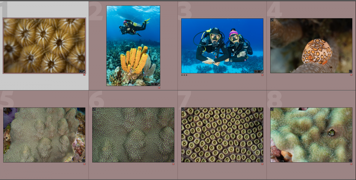

  2. This is a series of shots with the 28-60mm:
    1980672793_Screenshot2023-01-24at21_51_22.thumb.png.5238ed94cb6c06edc23ebea380f61f38.png

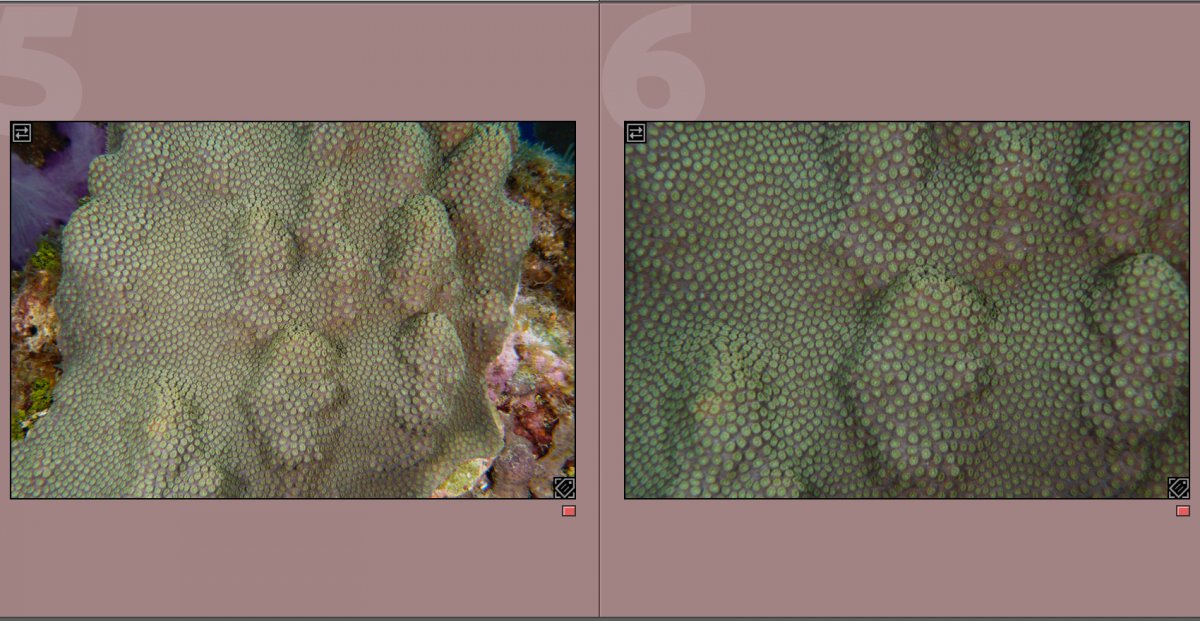

    The images 5 and 6 are taken with the lens a minimum focus at 28mm and 60mm respectively. At 60mm you get more subject magnification, but probably not as much as you would expect because of the more distance minimum focus.
    Just for interest 7 is the same coral shot with the same lens + CMC. And 2 & 3 are with the same lens + WWL.
    I've deleted these original images now. So sorry I can only share in this format.

  3. Here is a crop of the same screen shot - showing the two images a little larger.

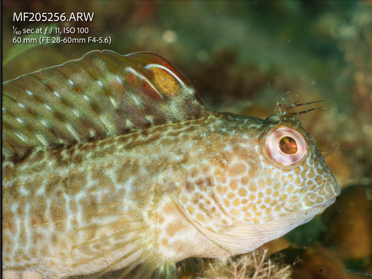

    However with the WWL-1 the lens keeps focussing pretty much on the glass two examples for you
    The first shot is uncropped and the second is 1:1 aspect but not cropped
    This is the 100% of shot 2 at 60mm
    Because the focal length and magnification is increasing depth of field is dropping. The shot is at f/11 but the background is soft this was intentional on this shot but some people like to have all sharp so take into account you are looking at f/22 and smaller for close up if you wanted all to be sharp
