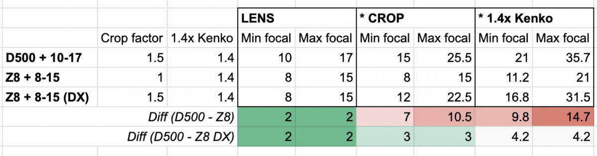

  14. @ChrisRoss @Nicool is there a comprehensive list of the Z9 and fisheye options?
    Currently with my D500, I'm able to use the 1.4x Kenko + Tokina 10-17, which gives me the nice zoom range, but can also cater for close focus wide angle macro.
    I wonder if the 1.4x Kenko (DG, not DGX) + Nikon 8-15 will give a usable zoom range? Or are there other, similarly priced options, that will allow for a better close focus wide angle setup with the Z series?
    I'm aware the comparison would be something like this, is that fair to say?
    Edited by sinetwo
    The 8-15 plus 1.4x is good between a zoom setting of 11 and 15 mm giving focal lengths from 15 to 21mm.  11mm is where the last of vignette from the circular fisheye disappears.  Not quite the reach of the 10-17 but it's the best currently available for a full frame camera.   In the WACP world there is the Nikon Z 24-70 and adapted Sony 28-70 lens usable from 28mm focal length.  To compare them you can use this table.  it includes the horizontal and vertical fields as well as the diagonal - it assumes a fisheye type projection for the WACP:
    You can see the WACP takes up where the 8-15 finishes with a slight overlap.  The WACP is closer to a 16-35 in field of view.  They are not interchangeable of course and are used for different purposes, the WACP has fisheye type distortion but doesn't quite have the in your face impact of the full fisheye.  I included the FCP - based upon the assumption that at 28mm it achieves full fisheye field equivalent to the 8-15 at 15mm.   It doesn't have the reach of the WACP at 70mm but it should give the same zoom range as the 10-17mm more or less 1.78x vs 1.7x.
    Edited by ChrisRoss
  18. 10 hours ago, ChrisRoss said:
    Thanks Chris, that's certainly useful and food for thought. I think based on the above, and because of the potential for a future Z8 housing with the associated megapixels, perhaps the most flexible is the 8-15 fisheye with a 1.4x teleconverter and using DX mode if necessary. WhilstI'd love to go with a WACP/FCP, my issue with that is that I'd need a fisheye lens in addition to the set up, with a large dome port for splits on trips.
    Meaning:
    Z8 + FTZ:
    • 60mm
    • 105mm
    • Zoom lens + conversion dome port
    • Fisheye lens + large dome port
    But with the fisheye lens I can get away with:
    • 60mm
    • 105mm
    • Fisheye lens + TC + large dome port + small dome port
    It might seem like I'm scrapping over details, but it helps me considerably given that my current set up allows me most of my camera gear in my carry on :)
