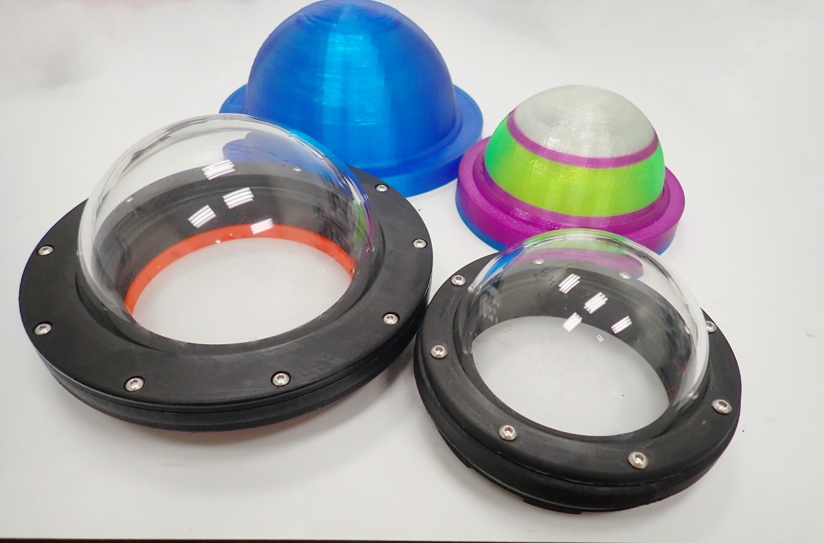

  6. The mail reason for the question was I was testing 3d printed parts for water tightness with a Nauticam housing and wanted to know the pressure  of the light changes. I just finished testing a 4 inch dome in a 3d printed Nauticam mount for the Lensbaby 180 circular fisheye.Will have test shots coming shortly

  10. I think the risk is mostly the strength of your 3D printed parts, you can calculate the force applied to your part from the cross sectional area (port diameter and the external pressure).  The test at vacuum only tests that the o-ring is seating.
  11. 1) I have no expertise in 3d printing, so (2) could be completely wrong.
    2) I have heard that some 3D printing processes can be slightly porous due to microscopic gaps between the blobs of printed material.
  12. If you want to pressure test your rig you need to take it to a dry diving chamber
    A vacuum detection system doesn’t prove anything with regards to ability to withstand pressure as that is linked to the collapse/damage of materials not the failure of a seal
  13. A quick calculation shows that a depth of 20m the force exerted over the entire dome pushing inwards is 345 lb or 157 kg for an N100 port, so you part needs to be strong enough to withstand that without distorting.

    As far as the 3d printing process is concerned, yes you are correct that small spaces can exist even at 100% fill. But with a good slicing(g-code management) recipe you can over extruder to fill these voids.  On previous attempts to make port adapters, I would have to coat with epoxy and put under about 5 atmospheres of pressure . The epoxy was "sucked" into the voids, rendering a water tight component.I am using a PETG material which is very strong.
    The ports have pasted the 24 hour vacuum test and now ready for the real world test. For pressure testing I prefer to test in water. You put "Crystal Light" a powdered drink mix on the interior of housing. Any leaks can be traced to the origin with the drip lines. Will test at about 5 atmospheres, without camera of course. I am confident the material has the strength to withstand the pressure. Printed at 100+ % fill it is extremely strong. The dome itself is about 4.5mm thick.
