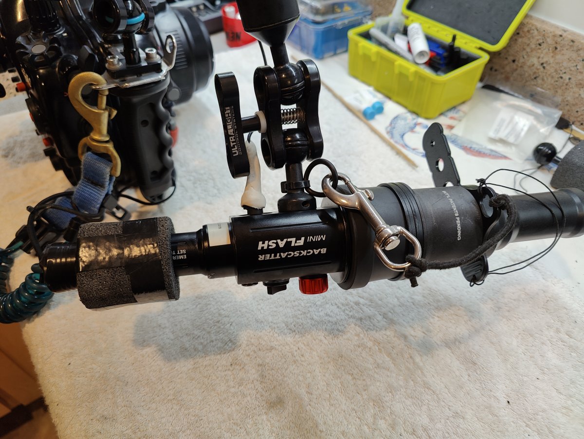

  8. Here is a picture. I use a 6" run of 1/8 bungie tied to a small boltsnap and the snoot. I ziptie a Din Oring to the ball mount and clip the snoot to that. I always have it clipped off, and just tear loose the snoot and let it dangle when not in use. You can clip it to your camera handles, BC D-ring, or whatever works for you as needed.
  9. Is that standard plumbers putty on the cable connection Dave?
    No, it is a soft silicone molding putty called Sugru. It provides some flexible protection for the fiber optic cable. Been using these for years. But it's kind of crude and messy.
    Recently, I've been experimenting with using my 3D printer to make customized optical connectors with a soft silicone like plastic called TPU. The result is something a lot cleaner, but I have not dove it yet. I hope to tomorrow.
