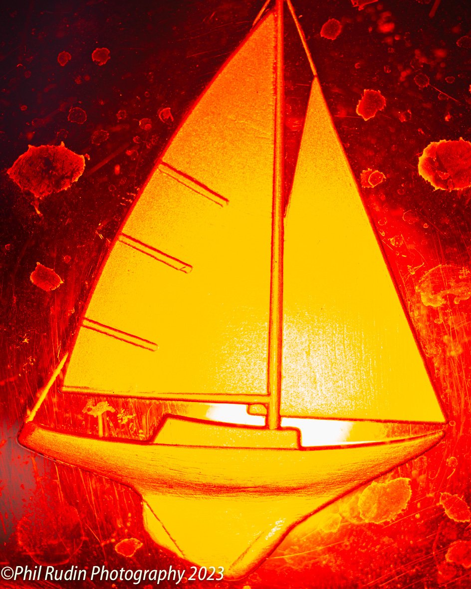

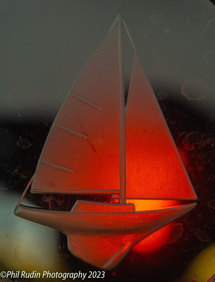

  3. The Backscatter MF-2's work very well with the IR filter on the trigger/on camera flash.
    Same setup with a red filter on the rear flash, behind the target. First without the IR filter triggered by the on camera flash and the second with the IR filter on camera flash.
