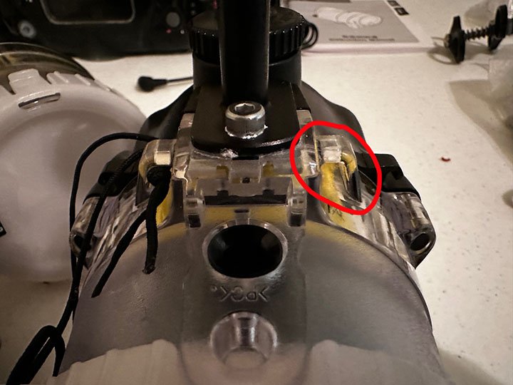

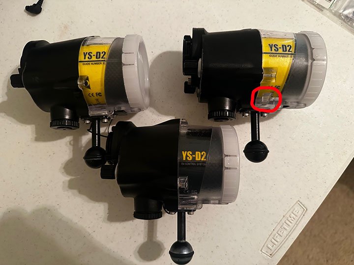

  1. I am helping a friend sell her husband's camera gear.  He passed away suddenly earlier this year and want to help lighten the load of everything she is going through.  I know almost all of his gear, but the strobes are a brand I've used over the years.  The strobes he used most recently are Retra Pro Xs.  The three strobes put away in a drawer were Sea & Sea YS-2Ds.  All three look different from the other.  One has a black body, the other two are yellow.  One of the yellow strobes has two cast-in tie loops on either side of the ball mount, the other has only one (just like the black bodied one).  The strobes all appear to work fine and are in really good condition.  So, the questions I have are:
    1.  Other than color, are there any differences I should note between the strobes?
    2.  I've done some searches for sold YS-2Ds - is there a difference in value between the 3 versions?
  2. I have owned several YS-D2's, both black and yellow labels. The black label ones were made in China in 2015-16, and often malfunctioned. As a result, Sea & Sea moved the YS-D2 strobe manufacture to Japan in 2017 and changed the label color to yellow, and added a J to the name,  YS-D2J. A yellow label J strobe is worth considerably more than one with a black label, a new YS-D2J yellow label strobe is about $670.
    A good way to find out the used price is to look in eBay, where today used YS-D2J's are $420 to $470.
    Edited by Kraken de Mabini
  3. Thanks for the input.  I had heard about the China vs Japan built units, but didn't know the differentiation.  Tested all the strobes today and the China-built one is flaky.  Works most of the time, but occasionally went dead and/or failed to flash.  Likely a parts unit.  Again, thanks for the input.
