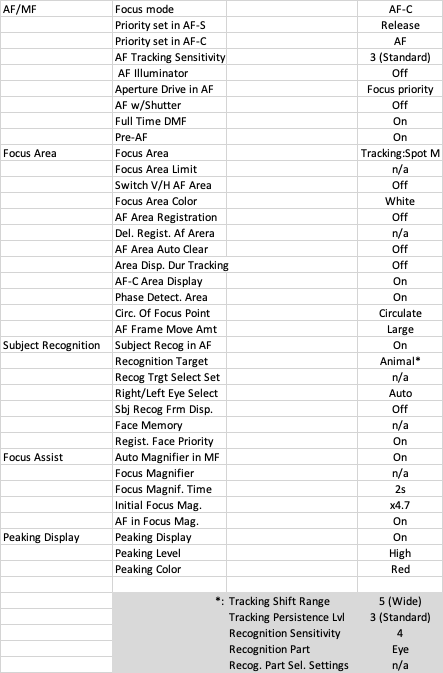

  1. I have now used my Sony A7R5 for a couple of weeks of diving vacations. AF with the Sony 90mm macro lens (+/- SMC-1) works very well, but I think there is still room for improvements. The camera is operated in manual mode for macro. The problem may be that there are too many options and therefore it is very difficult to find the optimum...
    I would be grateful if someone with the same, or a similar, camera would compare the options of the "Focus Menue", how I have set them on my camera with theirs and give valuable hints and/or discuss them. Here are the settings, that I use for macro photography:
    Thanks, Wolfgang

  2. I always use AF-C. I don't see the point of AF-S when you have AF points all over the sensor + unless you plan to take pictures lying all over the reef (to stay still).
    With the 90mm I use a mix of modes depending on the subject. When I am shooting fish I usually use Wide or Zone AF - as the camera is really good at identifying the subject fast and accurately - why make it more complex than point and shoot.

    For more crittery subjects - slower moving, often smaller, I will use Expand Spot or Tracking Spot. If the subject/situation means the subject is moving more I use Tracking Spot (this is analogous the 3D tracking I used on my Nikon).

    I tend to use the same for Super Macro - but may turn off AF With Shutter (I usually have it on). Although I have found that the camera is perfectly happy running AF with the SMC-1 and SMC-2. When we were shooting the blue belly blennies the camera would face recognise them and lock on the eye through both he SMC-1 and SMC-2 - so I even used Zone with them had the Af on the Shutter Release - just point and shoot.. I will wait for a full on macro trip before deciding exactly what I prefer and it will probably vary a bit between subjects. Nudis with Back Button, fish with obvious faces using AF on the shutter and subject recognition, with Zone.

    Thank you, this is precious information, as always...
    => Your changing of the focus area from Wide/Zone/Tracking Spot (eventually different sizes?) depending on motif, appears important (I was using, so far, Tracking Spot S or M and sometimes the small area became a problem (I guess when snorkeling with dolphins there will not be many images in focus then), sometimes it was very helpful (when getting the eye of a small subject, as e.g. the blue belly bennies with SMC-1)).
    I assume you assign a specific button, so that you can easily switch between these different focus areas?

    I just use the menus. I am still learning which modes I like for what. Once I have this fully nailed down I might make some short cuts.
    I’d also add that the AF is so good with the 90mm that often several modes do a fantastic job and all easily get the same result.
