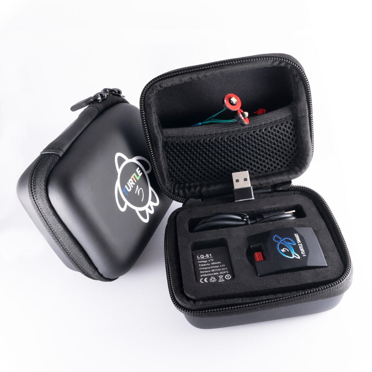

  14. The long-awaited SMART3 trigger has arrived! 🐒We’ve received tons of valuable feedback from you – our customers – and based on that, we’ve made several improvements that make the TURTLE not just one number higher, but truly smarter, more powerful, and more practical! The SMART3 series now comes in a brand-new, elegant box that protects it during transport and offers space for your optical cable, a spare battery, and of course, the USB charging cable. The package includes both USB-A and USB-C cables, making charging easy no matter what type of charger you use. You asked – we delivered! SMART3 is available not only in TTL, but also in MANUAL version, and it includes every feature that truly makes it SMART! πŸ’‘πŸ“Έ The main specifications can be seen here β€” of course, there are differences between each trigger, but the core additional features are the same across all models. Key Features – SMART 3 VersionUser-replaceable battery with 3Γ— the capacity of previous SMART 1–2 models USB-C connector for charging and configuration Reinforced switches and robust connector for LED or sync cord output "SMART" button to check battery status with led flashing 4 flashes = 100% 3 flashes = 75% 2 flashes = 50% 1 flash = 25% TTL & Manual mode switching via the camera menu – even underwater First curtain Second curtain Package Includes:1Γ— TURTLE SMART 3 TTL Trigger 1Γ— plus accumulator 1Γ— LED panel (or optional sync cord output) 1Γ— USB-C charging and configuration cable Available now SONY, Nikon, Olympus/Panasonic TTL and manual triggers. https://www.trt-electronics.com/shop/o-turtle-3-smart-ttl-trigger-for-olympus-panasonic-systems/57/ https://www.trt-electronics.com/shop/i-turtle-3-smart-ttl-trigger-for-nikon-dslr-s-and-milc-systems/56/ https://www.trt-electronics.com/shop/s-turtle-3-smart-ttl-trigger-for-sony-systems/55/
