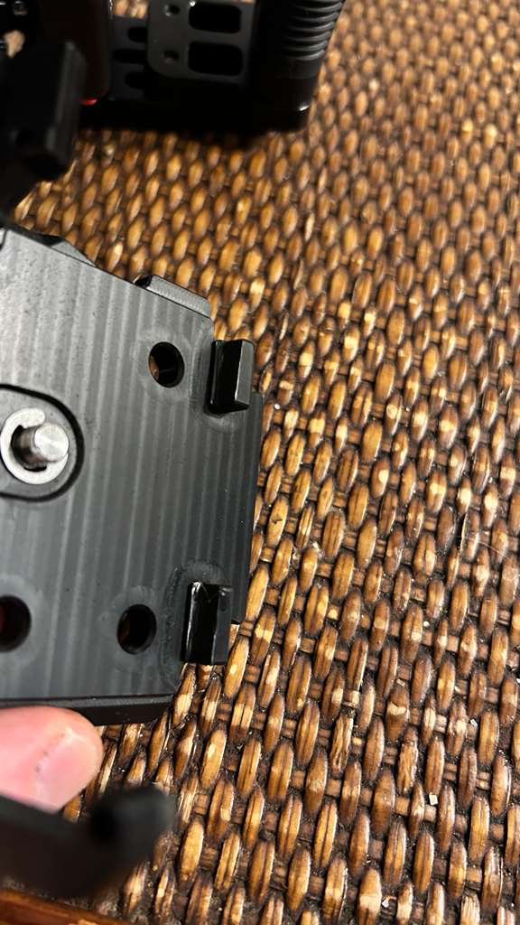

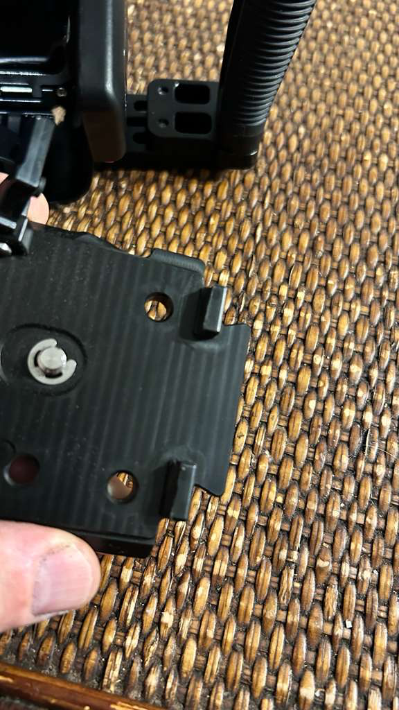

Canon R6 Mark III might fit in R6 II underwater housings and natevily offers now X-Sync speed of 1/320
These guys had to have about 1-2mm sanded off in with a dremmel (I'm sure hand file would work just as well) to let the camera sit properly on the tray since it's marginally thicker. But once I did that.. everything else fit like a glove. WhatsApp Video 2025-12-29 at 23.05.48.mp4
I'm happy to report that after some light dremmel work on the mounting tray (seems camera body + screen is 1-2mm thicker than the Mark II, the Canon R6 Mark III fits perfectly in the Nauticam R6 Mark II housing. As far as I can tell, every single button, dial, lever, etc - works the same as on the Mark II. So while the body does differ a little, the differences seem to be small enough that they're within the tolerences for the Nauticam R6 Mark II housing at least. Shucks. Now I'm seriously tempted to upgrade....
