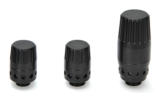

    How much buoyancy do you usually need to add for a macro and a WA setup? I usually add Stix Jumbo floats to ULCS arms.
    When I shot the Panasonic 8mm with Zen dome and also with the 60mm macro currently I used a pair of INON mega floats with 390 gr each buoyancy which was about perfect for both setups, being about 100-200 gr negative. I do see they now have a new model which has 460 gr which might be a little too much, though the Olympus fisheye is about 150 gr heavier which is about equal to the additional weight. I actually switched to using the mega arm with a 135 gr float arm I have since adding the 45° viewfinder, so I'm fairly certain the 460 gr float alone would work.
    I pair it with a standard 8"arm plus a long clamp between the two. The arm is the Mega arm model S:
