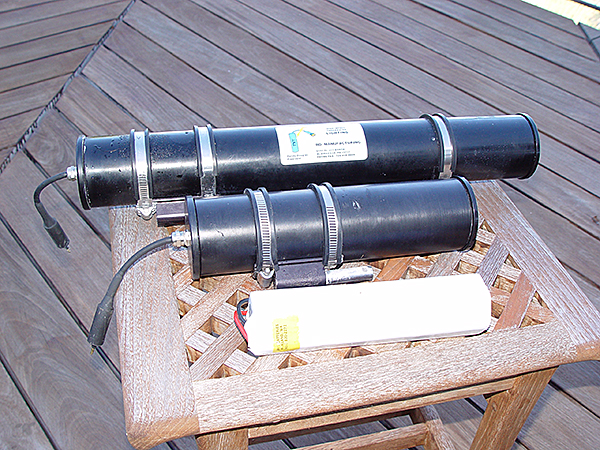

    Here is the rig I did quite a few years ago:
    Each battery pack was 21 cells of NiMH at 4.5Ah and weighed 3.5 pounds, producing a 25V pack that drove 24V bulbs from 50-400 watts. At high currents I claimed the packs were 100Wh to comply with airline regulations :bye: Also shown are the single pack and double pack cannisters that allowed me to dive with up to 450 Wh on my backplate at about 12 pounds of negative bouyancy. The batteries were rated to 3C discharge and would allow up to 1200W for about 15 minutes. The most I ever used was 800W and I got over 25 minutes out of them.
