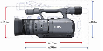

    I found a nice pic comparing the size of the FX7 to the FX1. I'm assuming the housings will be similar in size to the VX2000.
