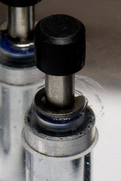

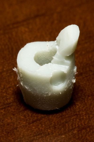

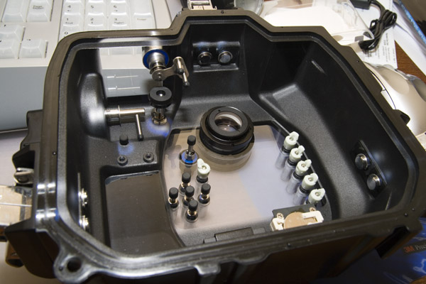

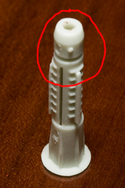

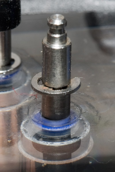

  5. Just uploading pics related to the button mod directly to Wetpixel as the original thread's previous photo links do not work anymore.
