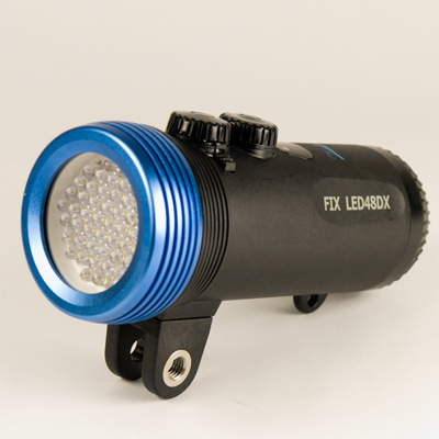

    6. The folks that have them seem to think they're OK, A lot of people are using the Fisheye LED 48X or the Fisheye Halogen. There are a bunch of good focus lights now, much brighter and wider than the S&S.

    Thank you for the suggestions on the Tokina 10-17, B&H has a used one for under 500, thanks again for the tip. I'm surprised I can't find one on ebay. The focus light you mention below, is this the one? mini.led.jpg

    The focus light a bunch of folks like is this one; We've had good luck with it. You can get a cool red diffuser for night dives.
    A lot of folks are using the halogen version too, more expensive though.
    The Hartenburg Nano is a very popular light too in the same price range as the Halogen FIX light,
