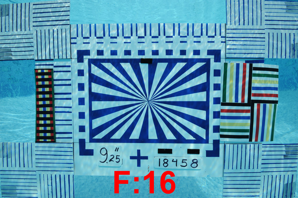

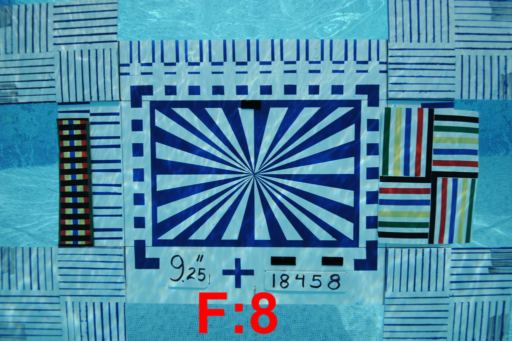

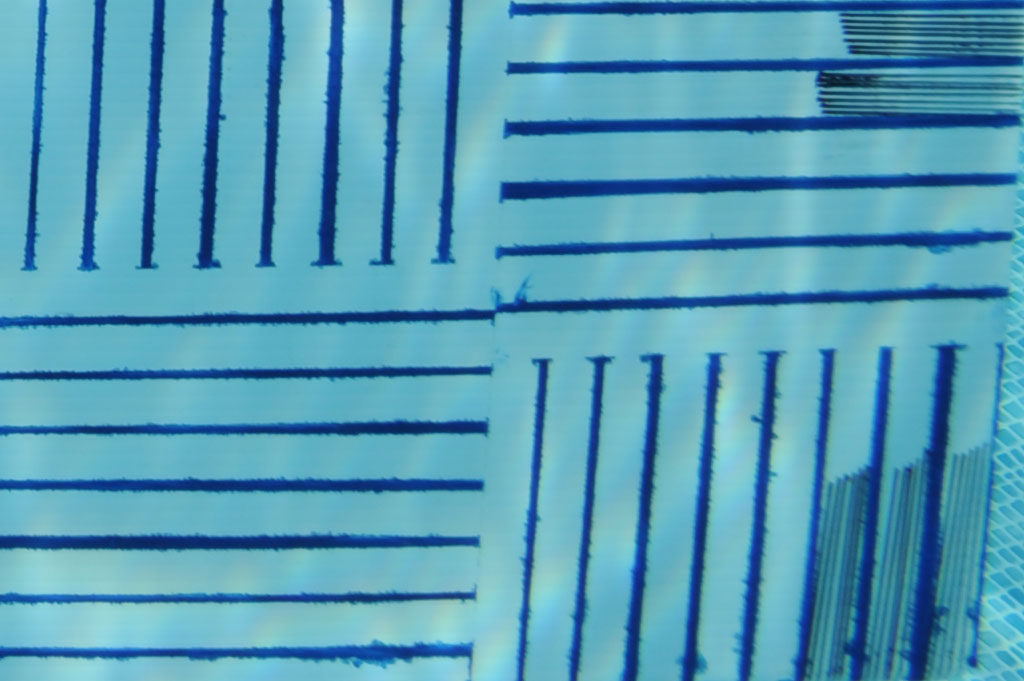

  12. Here are some of the results, wider than f:8 this lens is not really a bright performer, once you close it down it starts to improve and is quite fair around f:16, althought not a nobel prize winner, I would still consider that lens for full frame camera and definetly would recommend it for crop sensor.
    the last one is a 100% crop of the F16 frame.

  14. About a meter away if I recall, I move the tripod in and out in order to fill the frame area, but don't really note the precise distance, the big dome make a hell of a difference, anybody want's to shoot this lens with a full frame will have to get this large dome if they want anykind of success, next step will be testing the same lens on my D200 with various ports & extension in order to validate my optical bench results.

    Just want to clarify Jean; this is a test of the 14-24 right? From this test you are telling us that the 14-24 is only really beginning to have sharp corners at f16. This is what we've seen at least in pictures with other domes. I don't see anything here that says the larger dome helps any more than the 8' dome.
    I'm still hearing that the 14-24 is not really a great lens underwater, and that for now the 17-35 is a better choice for full frame rectilinear wide. It would be interesting to see comparisons of the 17-35 and 14-24 behind an 8" and a 9.25".
    I do appreciate what you have done here, but honestly I think all manufacturers should perform these tests with a variety of lenses, and post results BEFORE selling us products or making recommendations, and I'm not sure why this is not standard procedure.

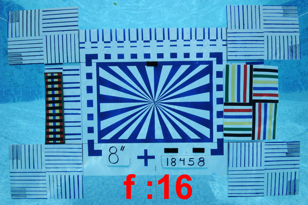

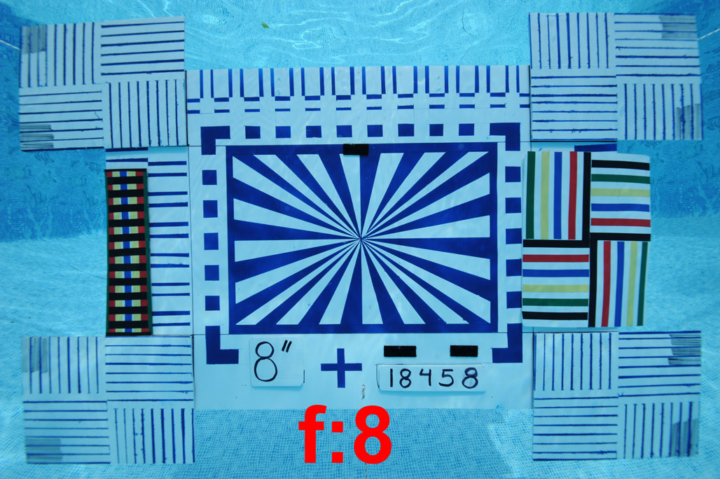

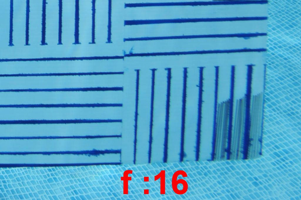

  17. Here is the result for the 8 inch dome
    and a 100% crop of the 8 inch at f:16
