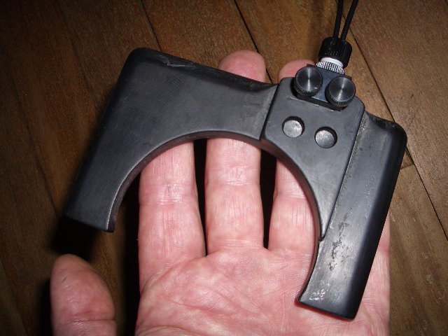

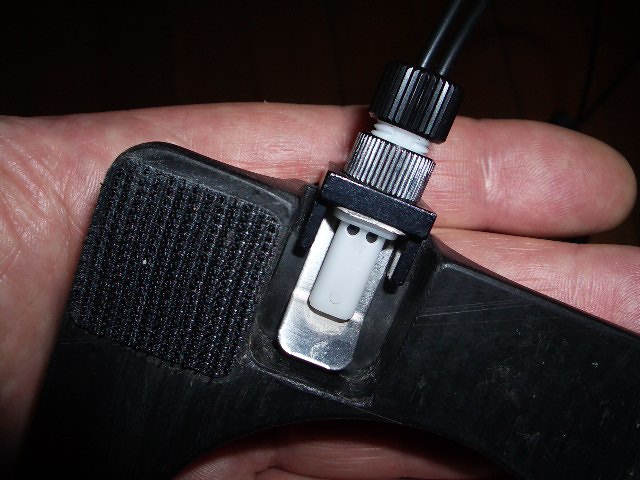

  4. For attaching two INON cables to an Ike housing, this is my solution. Note the two holes below the Cap set for also connecting Sea and Sea cables. The mask saddles the port and any rotational movement is prevented by pads of velcro. Illumination from the camera's flash is also prevented. This may give you some ideas for a similar arrangement to fit the OEM housing.
