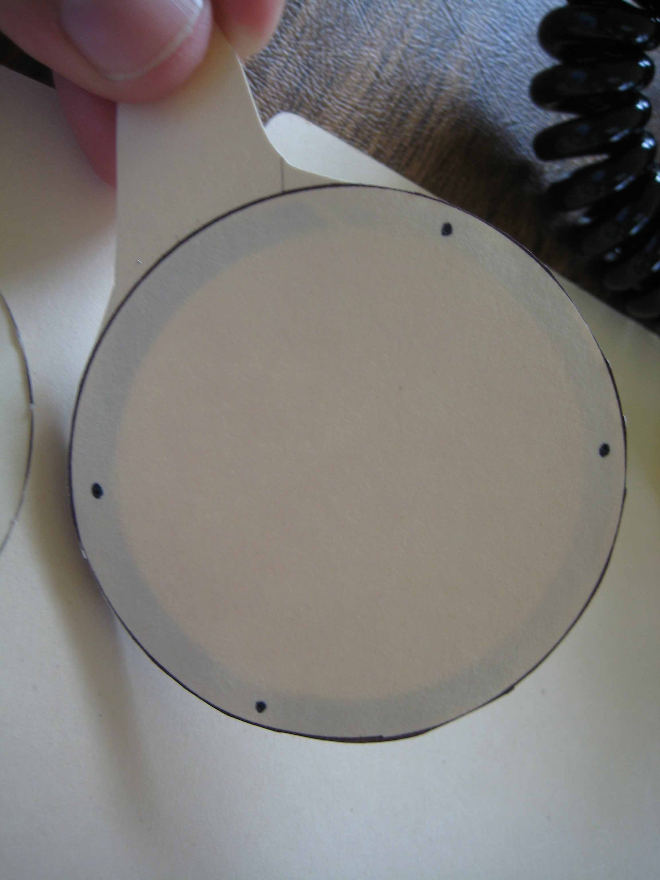

    6) Hold the cellophane over the lens port and using a sharp pin or needle, mark the centres of the two screws at the top and the two screws at the bottom, by pushing the pin through the cellophane.
    After you have done this you will have a template with four holes in it. You may find it easier to see the holes needed for the next step, if you draw round them with a felt tip pen.
    7) Cut two pieces of sellotape, about 2cm longer than the sides of your template, place them sticky side up on a flat surface, so that they form a cross, with one on top of the other.
    Then place the stepping ring, smooth side down, in the centre of the cross, so that it sticks to the sellotape.
    Next hold the template over the ring and carefully position it so that the holes you made in the template are now above and centred in the middle of the ring's rim.

    2 - I attempted to use the cellophane sheet method that Brian described, but had a tough time converting that template to the ring. Instead, I cut a file folder (or other rigid paper) in a 67mm circle, using the lens as a stencil; I also left a little tab on the circle as a finger hold (see picture below). Then I transferred the template from the stencil to the paper circle and glued the circle to the flat part of the step up ring. Using this method, I now had a clear and accurate template, and a natural guide for the drill bit once I got through the paper layer.
    3 - Brian's instructions recommend using a center punch to mark the holes. My first go around I actually used the center punch to create a divot for the drill, but might have been over zealous as it warped the ring significantly. Be gentle, it's delicate!

  17. Yes, the template can be done in many ways, but it's very important to get the centre of the holes you are going to drill marked exactly. If you are off slightly in the marking or the drilling, then you will find it difficult to screw the ring on latter as the holes wont line up with holes on the port. If this occurs you may have to make 1 or 2 holes slightly wider, which weakens the fit as there is not a lot of metal to play with. I could have used a bigger stepping ring say a 58m - 67mm which would be stronger, but the ring would then vignette the port when the camera is zoomed out to full wide angle.
    As you say, it would be a good idea to buy a couple of rings in case you don't get it perfect the first time.
