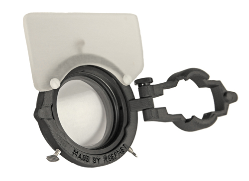

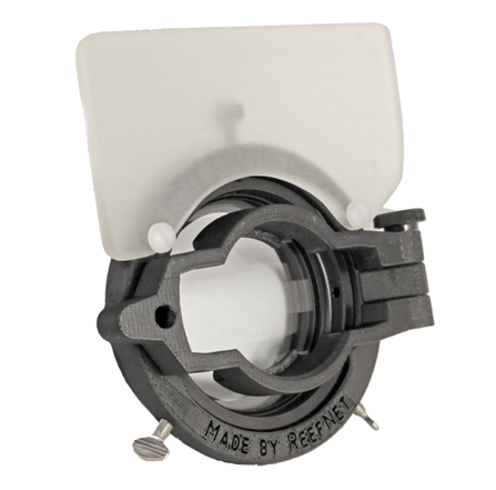

  19. I've got a few questions about that adapter (not yours Brian, very nice work btw). How does that adapter secure to the port? and how much $$?
    Asking because I'm in the process of producing my own adapters for various diopters and ports. Here's an adapter that I made for the Ike 67mm port, which can take the UCLs (amongst other lenses).
