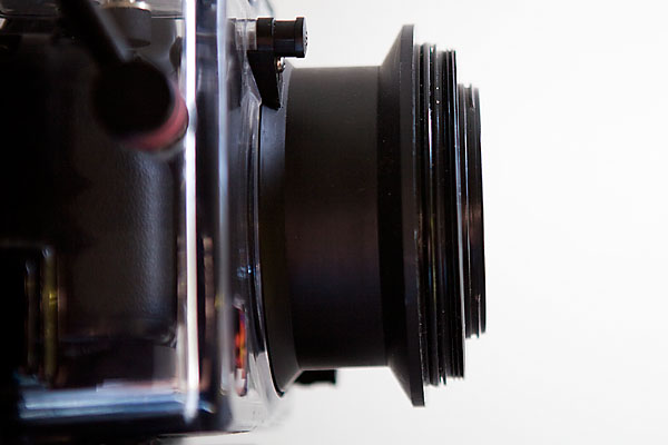

  4. You may have already said this, but what port and extension ring are you using? How far does the lens tip protrude into the port?

  10. You may have already said this, but what port and extension ring are you using? How far does the lens tip protrude into the port?
    James
    I use the Ikelite 8 inch dome port with the recommended 5510.24 extension ring. The red ring of the lens is flush with the end of the extension ring, which is exactly aligned with the inner, back part of the Dome structure. Thus, the outer glass of the lense does in reality not protrude into the dome, but is exactly at the back side of the dome.
  11. Interesting. Well if your dome is a complete hemisphere then this is the wrong extension. But I think the Ikelite port is only a chord of a hemisphere so the actual focal point of the dome is back somewhere in the lens - which is good.
    That looks about right to me but it's hard to say. There's nothing drastically WRONG w/ that positioning/extension ring.
    James
  12. Interesting. Well if your dome is a complete hemisphere then this is the wrong extension. But I think the Ikelite port is only a chord of a hemisphere so the actual focal point of the dome is back somewhere in the lens - which is good.
    James

    Bent - nice photo of that port. i think mine sticks out about the same. so same port.
