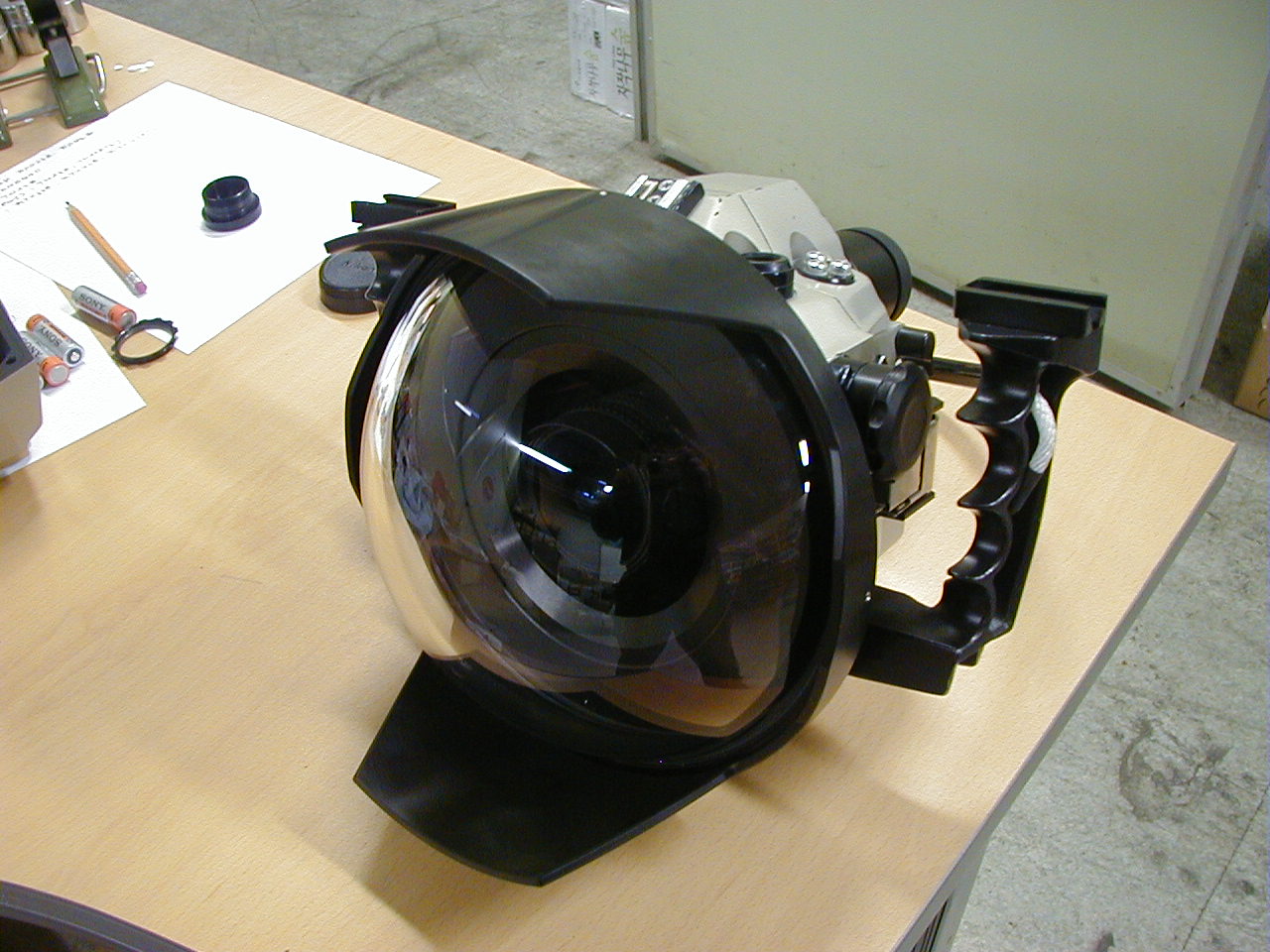

  2. Showing 'Zen' 8 inch glass dome port....

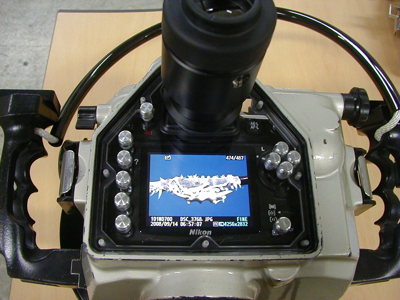

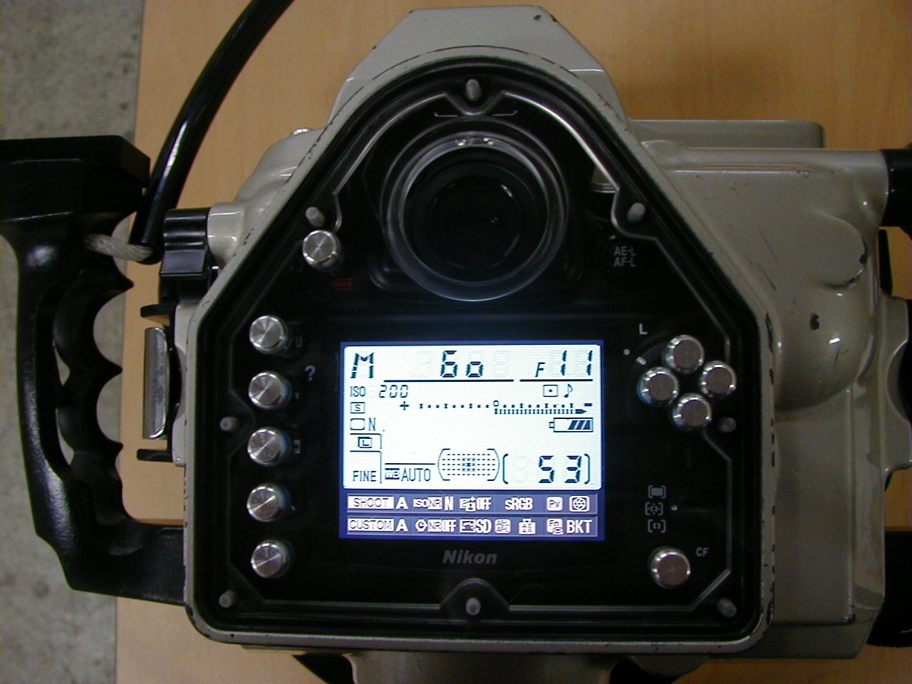

    You are clearly a genius. Even though Nexus probably did not design their housings with conversions in mind; their design clearly facilitates conversions better than companies like Subal, SeaCam, Aquatica et al. The argument that the precision required of high end housings negates upgrade planning is nicely refuted by your efforts Sam. It would be nice as we head into the recession years if the other guys would think about it.
  4. Hi Sam,
    Nice job! :uwphotog:
    Did you make the back plate by your self or did you contact nexus for a new one. I understand with the correct set of tools this would be possible. Nevertheless still takes a lot of effort to measure out the correct tollerances for the push button penetrations.....
    Can you tell me a bit more about your 8" Dome you use?
    thanks a lot,
    Matthias

    Hi,
    Thanks. I find from Anthis/Nexus web site that they are now offering new d200 housing back cover for d300 at around U$700.-
    but, I am not sure it is going to take d700 into it. Anyway, it was not that difficult project for me.
    Sam

    Hi,
    Re back window, I (Well...Machinist I am using designed it in CAD & produced it from his CNC) made it & it was not that difficult.
    It was a lot easy to put d300 as it even has a room to pop up internal flash for fiber-optic connection but, d700 conversion has
    much less tollerance (very tight) & am not sure anybody will do this conversion commercially.
    Re Zen dome port, I bought it from Reef photo & was told they are getting this glass dome from Japan & it is one of best quality
    optic available in market. Coated in & out of dome. They have model for S&S,Subal & Nexus(M5 port) and I think I can get/change
    different adapter for different model if I need to by looking at it. I will know more when I use it next week.
    Sam

  8. Hi Sam,
    Are the zen 8" domes cheaper than the nexus domes?
    your d700 kits include: buttons? base plate? and back window?
    is that the inon viewfinder fitted in your images? I wouldn't use an accessory viewfinder, nervous about how vunerable they look. So would I need to pull off the eyepiece from the d200 back window to put it on your d700 window?
    Mary

  9. Hi Mary
    regarding the dome question.
    - Largest Anthis nexus optical glass dome is currently only 160mm in diameter.
    - there is as bel a 170mm acrylic dome with reasonable deeps rating, and a 230mm acrylic dome with no deeps rating mainly designed for surface half-half images
    currently nexus has various smaller optical glass domes especially designed for certain Nikon lenses 10.5mm / 15mm / Tokina 10-17mm / .... but not real comprising do a "optical super dome" (one dome for all). Especially Canon users do have not a big variety apart from the Tokina 10-17mm. I still hope....!
    Best regards,
    Matthias
