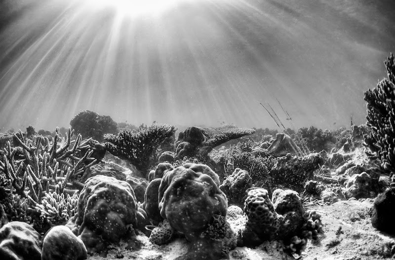

  14. One of the earlier ones in B&W. Quite dramatic I think.

    The B&W looks great. Were the sun rays as prominent in the individual shots, or are they more prominent due to the HDR layering? I ask because that was what first caught my eye, both in the color and B & W images you posted.
    Thanks again.

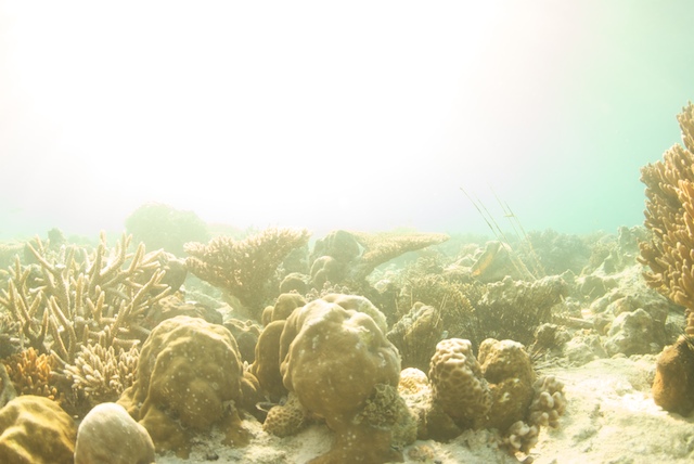

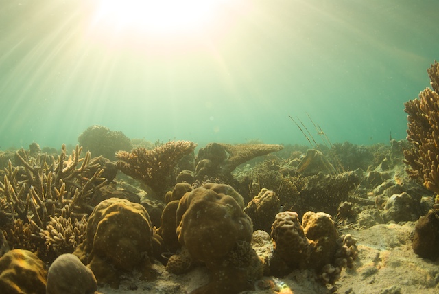

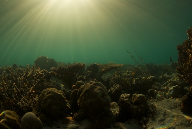

    Take a look at these 3 original raw images. Rays are there in each of them but not rendered nearly as well in any of the single images. I think there are 2 areas I am going to love HDR underwater; enhanced detail in the shadows, and better rendering of sunrays and / or sunballs with combined images over any single one exposure image
    That's exactly where I see the benefits of HDR tonemapping (We really do need to come up with a better term until displays catch up - HDR\LDR sounds like an experimental drug and is not descriptive enough).
