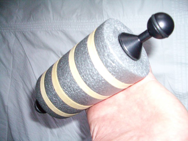

  18. Thanks for all your feedback chaps. There is an ideal cross linked closed cell foam out there. Its probably not Divinycell though its compression strength is excellent. Looking very closely at plastazote. The semi rigid (PK grades) seem the best. Also worth a look is the polyamide foams (NB grades). A denisty of about 45-50 kg per M3 would seem to be about right (assuming no one wants to take this to 100 metres!)
    Machining collars is the major cost and there is no alternative if using sheet foam. However...
    Check out extruded foam pipe insulation. Usually this is 28-30 kg per M3 density wish will compress and loose buoancy at recreational diving depths. With some persistence it is possible to find 45 kg per M3 density which is much better and cheap as chips. Look for 28 / 20 (28mm ID and 20 mm wall thickness). 28 ID provides a perfect 'grip fit' on the 30mm OD of a ULCS float arm.
    This is what it looks like fitted to a float arm.

  19. This is what it looks like fitted to a float arm.
    That looks quite neat; have you tried it out yet?
    R
  20. Hi Ralph,
    I'm taking them for a proper dunk at NDAC either tomorrow or Saturday. I do expect that there will be some compression and reduction of buoyancy 'at depth'. I'll probably pootle off to 40 odd metres before hunting pikey things in the shallows. I'll post my findings.
