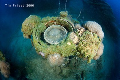

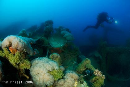

  15. What is the strongest/most powerful strobe on the market today.
    Are you sure that this is the best solution? If the visibility on your dive site is excellent, then it may be, but if there is any particulate matter in the water, the biggest, most powerful, strobe is going to to give the most backscatter. A pair of smaller strobes and balancing against ambient light might give better results. The modelling lights on the strobe are less useful than they seem in wide-angle photography, as they will usually be aimed to either side of the target, lit by the overlap between two strobes. Single strobes, especially if they are the dominant illumination, can easily give unpleasant results with wide-angle lenses.
    Two medium power strobes (each about 100-degree coverage), visibility about 6-8m, 10.5mm lens (180-degree diagonal).
    Same dive and set-up.
    The water was tropical, but at 45m the amount of light was relatively low. The camera, a Nikon D70, has much poorer low-light performance than the current generation of D-SLRs.
    Tim
    :dancing:

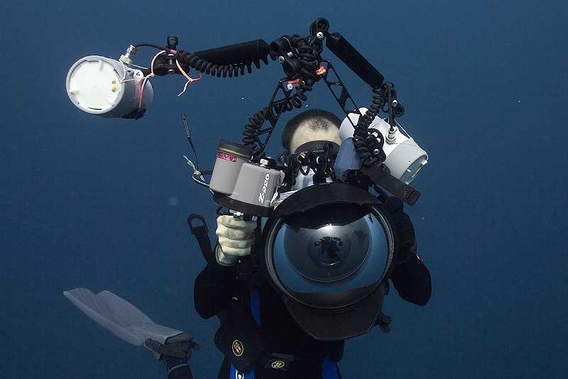

  19. I have never seen 3 strobes connected :-)
    Gisli A.
    The simplest way is to fire extra strobes using a built-in slave. I have used up to 6 strobes this way. One being hard-wired to the camera to act as the trigger, the rest being slaved. See:
    http://stephenfrink.blogspot.com/2008/11/s...tographing.html
    The main issue is how to mount all those strobes! :(
    Alternatively one can use a combination of multiple bulkheads and Y-cables. One needs to be careful not to get a tangled mess! Also many cords are rather short. If you want the extra lights farther away, slaving becomes more practical. A number of years ago I saw that EO extension cords were available. Maybe they still are. If one already has strobes with built-in slave sensors, this is a less expensive solution.
    Tom :dancing:
    Here you go... our own Wiseman with his messy 3 strobe setup.
