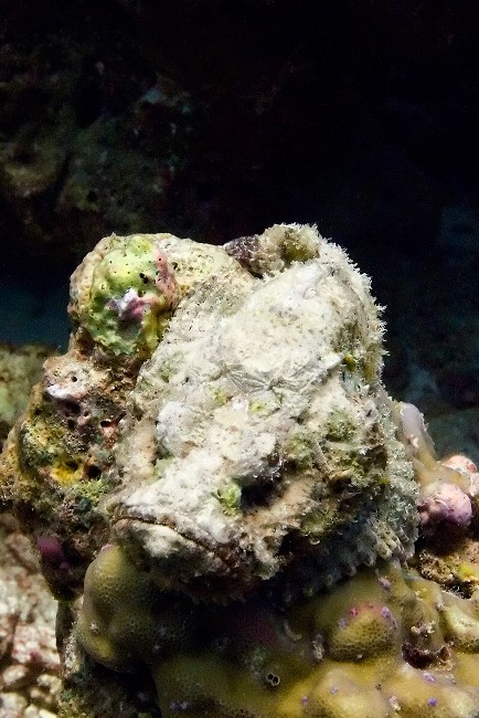

  4. There's a real limit to how much you can do with ambient light, especially if the images were shot on an automatic or programme setting. If you use a "cloudy" setting you can force the camera to record more red, but as you have to reduce the blue channel in post-processing, there is still a problem with the image as the brightness (luminance) falls off rapidly and reduces the amount of red that can be restored. For shallow dives, to about 5m, in tropical water it works. The depth can be extended by using a filter (such as the URPro or Magic filter), but mostly we use strobes.
    This was taken at 10m, and it was very difficult to recover much colour:
    Have you tried the opposite tack, and converted your images to black-and-white with an increase in contrast?
