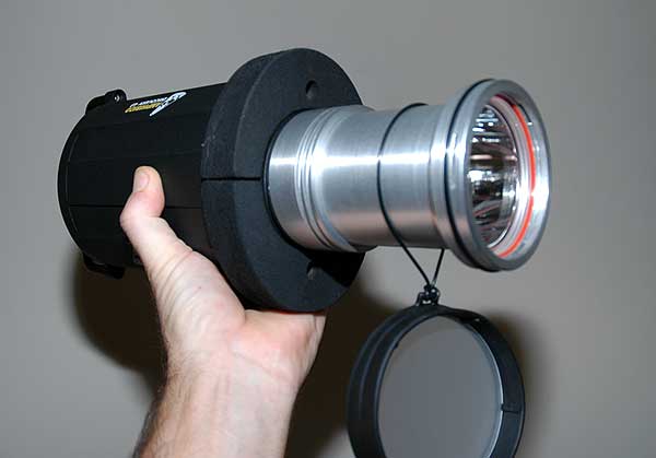

  1. Hello All.
    Well as some know I have been using a couple of cheap 24 Watt HID Darkbusters and have been getting some pretty good results.
    Today I got my hands on Amphibico's mighty Discovery G3 35/50 watt HID light.
    So far I'm impressed.....this is one cool light......could this mean the end for my Darkbusters...
    More soon......

  3. Hey Wags - those look to be far larger than I expected! Look forward to hearing your thoughts....
  4. Well it is Dean if you convert it to the AUD dollar.
    Bryce it is indeed a beast but it does not weigh much.
    It puts out some light alright and most would probably get by with just using one.
    Let me play with it is some more (the light that is) and will post my thoughts. :D

  10. I can't seem to find the specs on this light from the Amphibico website...curious to know how much it weighs and what the burn time is.
  11. Her ya go.
    Tech = Xenon Gas HID /Colour temp 4200k
    Weight
    On Land = 5.25 lbs (2.38kg)
    In Water = 6.35 oz (180g)
    Burn time
    2 hours @ 35 w
    1.15 hours @ 50 w
