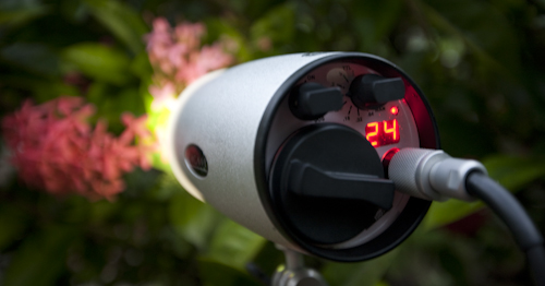

  1. I just returned from teaching my Digital Master class in Bonaire, and used it as an opportunity for doing some overdue testing. The results of the corner testing on various lenses is at http://wetpixel.com/forums/index.php?showtopic=28444 over on the D-SLR forum, but for myself I was eager to try out my new Seaflash 150 as a single strobe for wide angle.
    I used to shoot that way a lot, going back to my old Subsea 150 and Nikon SB-104 and Ikelte 200, because I liked to be able to handhold a single flash, put it where I want, and let ambient light essentially be my second strobe. Of course, the Subsea and Nikonos strobes are no longer made, and would be too big and heavy to travel with anyway. Plus, no one laments not having to buy the 510-volt battery packs of the old Subsea MK150, no matter how nice the light was for wide angle.
    As strobes evolved into smaller and smaller packages for travel considerations, I began to wish I once again had that one strobe head that could cover my full frame fisheye lens when needed, and punch through the water column to light a distant subject if it had to. This strobe seems to offer that kind of performance ... Big Strobe coverage and power in relatively Small Strobe size and weight.

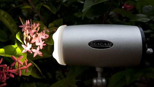

    Here's the strobe with the new accessory diffuser attached:
    Here's the kind of coverage it gives with the Canon 15mm on a 1DsMKIII, single strobe only:
    Here's some more random shots from Bonaire, all with Seaflash 150. The wide angle shots are single Seaflash 150, and the fish/macro shots usually had an Ikelite DS160 on the right:

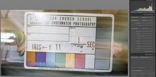

    Jordi - Thanks for the kind words ... and yes, rear curtain synch does work so long as all 5 pins are in hot-shoe (necessary for E-TTL as well) and an S6 connector is installed on housing. Nikon can work in i-TTL with 5 or 6-pin connectors (N5 or S6) but Canon requires all 6-pins.
    See http://stephenfrink.blogspot.com/2008/12/r...h-it-works.html for more on rear curtain, or see this photo to see trailing light behind implied motion, typical of rear curtain synch:

  17. Jordi - Thanks for the kind words ... and yes, rear curtain synch does work so long as all 5 pins are in hot-shoe (necessary for E-TTL as well) and an S6 connector is installed on housing. Nikon can work in i-TTL with 5 or 6-pin connectors (N5 or S6) but Canon requires all 6-pins.
    For more about S6, in general, see http://www.seacamusa.com/s6-connector.shtml
    I can't speak for E-TTL and rear-curtain synch functionality on all housings, as I've only tried on Seacam. But, the strobe is certainly enabled, so long as the synch sockets and housing circuit board will support the technology.
    As update, I just tried rear curtain synch (RCS, aka 2nd curtain) on my 5DMKII and Seacam housing. Unlike the MKIII where RCS is set be a custom function, with the 5DII the camera has to detect the Canon speedlight to enable the external speedlight control. With my Canon speedlight attached to hotshoe, no problem. With Seaflash 150 through the Seacam housing the electronics aren't detected and menu is not active and 2nd curtain can't be selected. E-TTL works though.
    So, to amend the info above. Yes to RCS for Canon MKIII/Seacam housing, apparently no to RCS for Canon 5DII/Seacam housing. At the moment anyway.
