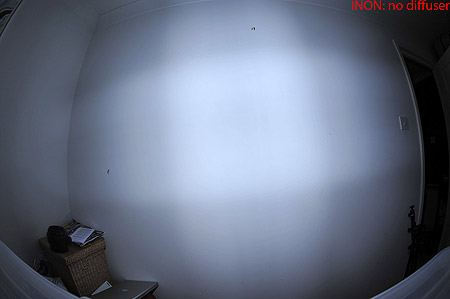

    Just FY interest, this is the beam pattern that you get if you fire an Inon Z240 against a wall on land:
    with apologies for the picture - this was part of my own soft box tests - not intended for publication! A cross shaped beam pattern, with such rapid fall off is hardly an ideal starting point. Although UW (in my pool versions of this photo) the diffusion through the water makes the cross much harder to see. Plus the INON diffusors do a very good job of turning this into a soft circle of light. My UW softboxes are better still!
    Alex

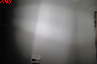

  16. Also, keep in mind that the lens on the Inon is curved and will alter the beam pattern underwater. That's true of any strobe, of course.
    I have a rig that I built to do underwater beam pattern tests but I fear it will soften the pattern a bit and wouldn't show that pattern as dramatically as your image, Alex. I agree that doesn't look like the ideal starting point. After seeing your result I looked at the Z-240 face and I see how that pattern comes about.

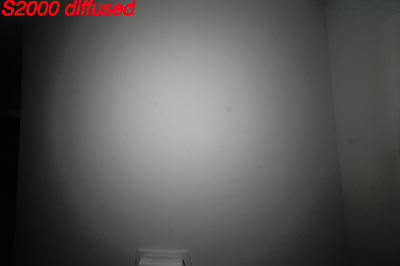

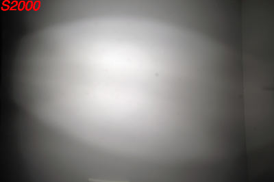

    I have an S-2000 and the strobe tube diffuser is substantially different than the Z-240. I did a quick test similar to yours. First is the Z240:
    Here's the S2000:
    The Z240 appears to have a little better beam when diffused and is a stop brighter.
