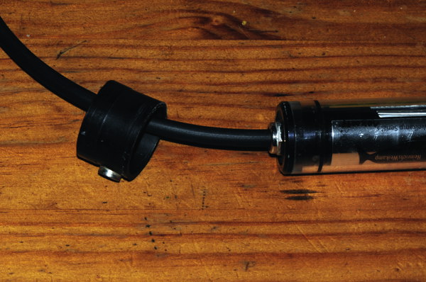

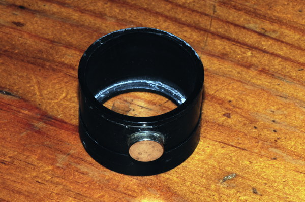

    Hi TimG,

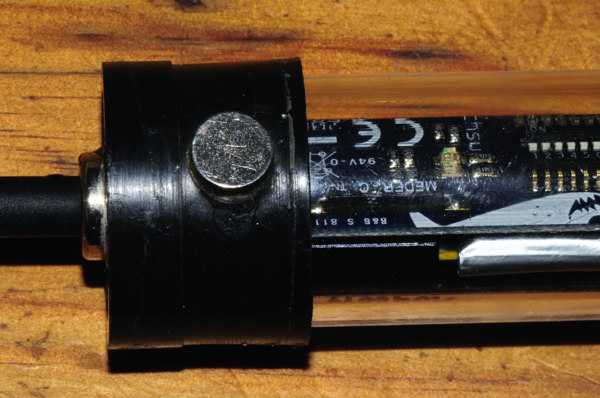

    I use the same housing with the HeinrichsWeikamp External Converter (I think you use the external converter also)
    This is the settings I use:
    i-TTL - (Inon) ON/OFF knob - S-TTL position/Adjust power knob - Any position/Advanced Cancel Circuit - Push in
    Manual - (Inon) ON/OFF knob - M position and ajust power knob to the power I want
    - FULL and power knob - Any position
    I change from i-TTL to Manual with a ring magnet (Manual mode with the ring magnet on the external converter)
    I hope this help you.
    Best regards,
    Tigershark

  4. Hi TimG,
    I only use i-TTL on macro shots, never with WA. I think the i-TTL is very good in the great number of macro shots, but if you like work with the light forget it.
    You can see information about the magnet in the HeinrichsWeikamp handbook for Nikon, page 13 (One way for change from i-TTL to Manual).
    The HeinrichsWeikamp provide the magnet.
    http://www.heinrichsweikamp.net/blitz/en/index.htm
    A - Ring Magnet
    B - In Place for Manual
    C - Out of Place for i-TTL
    Best regards,
    Tigershark

    Elmer and TigerShark: thanks a lot guys. Very helpful. I've got to look at the package again. I sure can't see anything that resembles a ring magnet!

    Tim,
    did you find your magnet? I'm in the same situation. I don't think my package included one, first time see that piece in the photo.
    Simon
  9. Pretty sure they are not part of the package. I know I didn't get one!
    Hamish.
  10. Nope, I sure didn't get one either. I contacted my supplier, Ryan at Reef Photo in FL, who said this happened often. He kindly said he'd get one to me.
