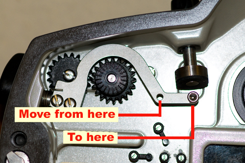

  19. Hey Log
    Here's a little nugget that I've recently picked up.
    For Macro shooting I assign the AF-L / AE-L button to Auto focus Lock.
    Menu > Controls (f) > Assign AF-L / AE-L Button (f6) > Button press > AF Lock only > OK.
    I can then auto focus with the shutter release lever and by pressing the little lever on the housing (by my right thumb) lock focus and re-compose before taking the shot.
    Now I know this is old hat but I've only just found out that you need to move a little screw on the lever inside the housing to access this function (see below)
    They don't mention that in the Subal manual!!!
    Nige
  20. Hey Log
    Nige
    Hi Nige,
    Your a bloody genius, fair play to you old hat but new to me and i am sure new to many more. Keep on posting. Take care.
