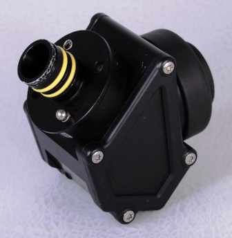

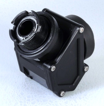

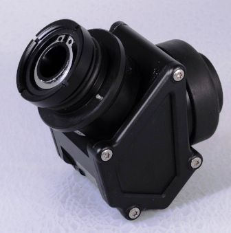

    This is the original viewfinder I got in eBay (USA) for about $250, it had never been in the water. This is the threaded type which needs more work to be adapted:
    This is the same unit after modification, a new thread has been machined over the original thread. It may not look a perfect engineering solution but it works perfectly and screws in smothly and tightly in the Ikelite housing which hasn't been modified. I can unscrew it for traveling or go back to the original viewfinder whenever I want. Modification has been made by http://sagadive.com . The dificult part is that the viewfinder needs to be in the correct position (top side up) at the exactly same turning angle where the O-ring is compressed: so when you screw it all the way in, the top part must stays on top, so slight changes in lenght have to be made:
    this is the viewfinder installed in the housing:
    Let me know if you have any questions. I´ll be here until Wednesday night.
