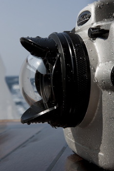

  1. Hey!
    The last BOOT (Jan. 2009) in Germany Harald Hordosch presented a new Seacam Mini Fisheye-Macro Dome.
    I was to busy to check the details, and now, I can not remember the details.
    And I even can not find informations in the web.
    Except a few infos at a Belgium site.
    For example this pic:
    Has somebody here more informations.
    It it only for the Fish-eye or do you have to use a 1,4x converter?
    Thanks for more informations
    Schorsch :)

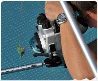

    Here it is on the new Seacam site, German only for now. English in 3 weeks Harald says:
    Fisheye macro port - http://seacam.com/de/produkte/frontports/sonderports
  8. Here it is on the new Seacam site, German only for now. English in 3 weeks Harald says:
    If you follow the link there are a couple of interesting illustrations of what the port does:
    photos ©SEACAM
    Based on the obvious close focus and apparent lack of distortion, I ordered one of the ports. It appears like it should be a very useful wide angle tool & am eager to try it out.
