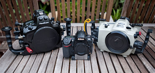

  1. Thought I'd start a discussion on the Nauticam D700 - as it hasn't been discussed yet!
    Similar design philosophy to other Nauticam housings, although without the piano keys of the Canon 7D. Ergonomics are very impressive.

  5. I was a little disappointed to not see any subal port adaptors on the nauticam website. And their website needs a little work. For instance, on the port adapter page, those tiny images are 3 megabytes a piece. It's nice that you can view them fullscreen if you know how, but just make them clickable then and only show 10MB in images if someone wants to.
  6. Alex I have to say with the side by side, it sure looks like Japanese manga vs Austrian sleek. That Nauticam controls really stick out vs the Subal. Will be interesting to see the how you like the big controls. That porthole looks like it can fit those Zeiss Compact Primes :)
    Cor, I think that's fair to say for most every manufacturer who have a tendency to have more design issues with their website than their housings. ;)

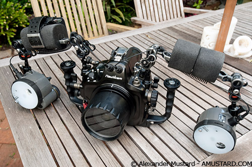

    Hi Cor,
    Here is the housing with viewfinder, strobes etc - with the 60mm and 60mm port from Subal on. I have a Nauticam port too - but want to test the adaptors - as that is what many potential users will be considering.
    Alex
  11. Alex,
    looks like a great set up, and putting the computer around the bouyancy foam... great touch. is it just where you have put it for now so u dont forget it, or do u dive like that, kinda heads up display style. Do many photographers do this?
    Never thought of that but will give it a go.
    Sorry for going a little off topic...
    Olly
  12. Alex,
    Olly
    I've been diving with the computer on the arm for a while - the foam is great for that, but this is the first time I have seen anyone else do it. It does work well.
  13. I've been diving with the computer on the arm for a while - the foam is great for that, but this is the first time I have seen anyone else do it. It does work well.
    Whoa, what a great idea! I dive with a console computer and one or two old hockey puck style ones in a pocket or clipped on the BC. I will mount one of the back-ups on a floatey arm next outing. Thanks.

  14. Since I have had that computer I put it there. There are many pictures of me in circulation with it like that! For example in this article here!
    It is not a Nauticam specific feature. Its a STiX feature!
    Alex

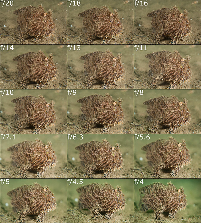

  18. To get back on topic. Two dives with the housing today. First with 60mm, second with 15mm FE and TC.
    Did a TTL test of the optical TTL system on the morning dive. TTL produced consistent and accurate exposures across a wide range of apertures.
    D700 + 60mm. Nauticam housing. 2x Inon Z240 strobes. All 1/250th @ ISO 200. Aperture indicated in photos. Strobes on TTL through out.
    Alex
    Edited by Alex_Mustard
  19. The system as you have it, would be very close to my choice. So it's very positive to see such good ttl results. Can't wait to see your review.
