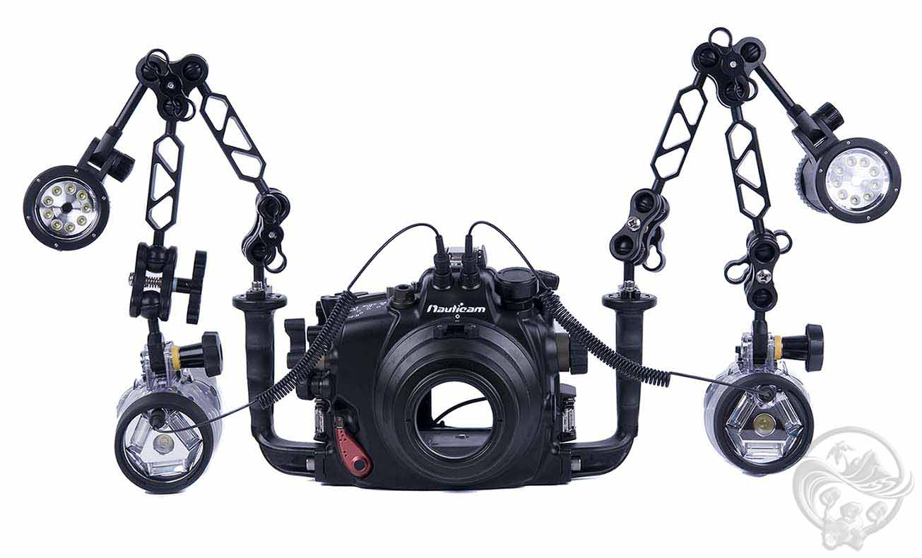

  3. Here is the setup I am using for any of the DSLRs that shoot video. It allows me to have both strobes and video lights. What you can see is I am using a pair of Fisheye Fix 1000 LED lights. They work great for macro or CFWA, but not quite powerful enough for big animal or wide reef scenes. All in all its a great set up for these cameras.
  4. Hey Mike did you think about mounting the video lights on the seperate internal mount points on the housing? I was thinking that if they were used mostly for macro and CFWA they wouldn't have to be that far away. I'm speaking from ignorance since I haven't tried it yet.
    Steve
  5. Steve,

    I agree too about the arms... I too use lock-line arms for my Sunray 1000 light heads.. and they are very easy to use and adjust on the fly.. with one hand and quickly.. which is of great value. You can buy lots of adapters and parts online at www.modularhose.com for them at great prices too. The only downside of lock line arms is when a diveboat deckhand tries to hold my housing by the arms. I have to be sure to show them were to hold the rig elsewhere. Lockline arms can come apart topside. But for underwater and using smaller lights.. they are great. I sometimes dive in very heavy currents and rarely have any issues.

  15. Hi all, sorry for not responding sooner I havent been on here. To answer the question, yes I have put the Fix lights on internal ball mounts, and Ive tried it the way in the pic. Both work fine, its a personal preference to be honest. When I went to Florida to test dive the prototype with CP, they had the Fix lights on the outside mounts, and the strobes on the inner mounts...that personally I did not like so I had moved the strobes to the outside. All personal preference.
    With regards to overall lighting, I like the Fix1000s for this set up. Using a set of bigger lights such as the SunRay 1200 or 2000x is great if its going to be dedicated for video only. Carrying a set of strobes, plus a set of these lights with battery packs mounted on the bottom is way too much...and personally, like Ive been saying all along....I still feel these cameras are STILL cameras, and good for some video clips....they are not what I would consider dedicated video cameras. If I plan to be a video shooter, then I would still take my video camera and a set of video lights.
    That being said, for small video clips, macro and fish video, the Fix are ideal for me.
