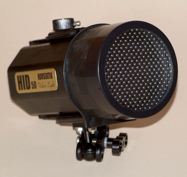

    As far as the Intovas go...I forgot to mention that I use a clear "prismed" type of diffuser on the front. This increases the beam angle significantly and softens the light nicely, without much loss of intensity. The 3 hour burn time is also sometimes a big advantage.

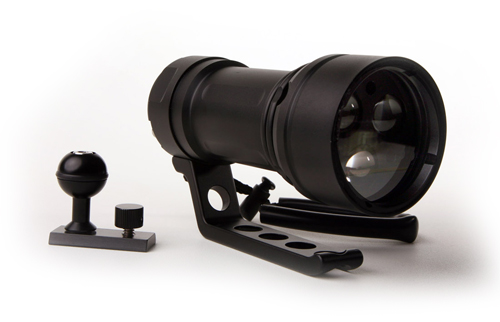

  16. If you are looking at Intova, you should also look at the new Darkbuster 12 Led. More than 700 lumens delivered with a difuser, and possible to buy mounts that fit most camera/video arms.
    Better specs than the Intova. 4 hour burn time, Li-ion batteries and recharging without opening the light

    I'm sorry that I can't post a photo of my Intova/Diffuser setup at the moment. I've loaned it to a friend for an extended Easter dive trip.
    However, it is essentially identical to the push-on diffuser we supply with our HID video lights...just a smaller diameter.
    I've found that the clear "prismed" type of diffuser material distributes the light very evenly without losing too much of the intensity (unlike a simple translucent diffuser).
    As far as the Darkbuster LED is concerned...haven't seen one yet. I'm a bit concerned, however, that they seem to be all plastic with no metal heatsink going out to the water (I might be wrong on this...but I can't see one in any photos).
    Plastic is a good thermal insulator...the opposite of what LEDs need. On our LED cases we have a very substantial heatsink which channels the heat right through the ABS/polymer case and out into the water. We've measured internal temperatures (ie Junction Temp), with the lights in the water. Without the heatsink, internal temperature builds up alarmingly...not good for the life expectancy of emitters!
