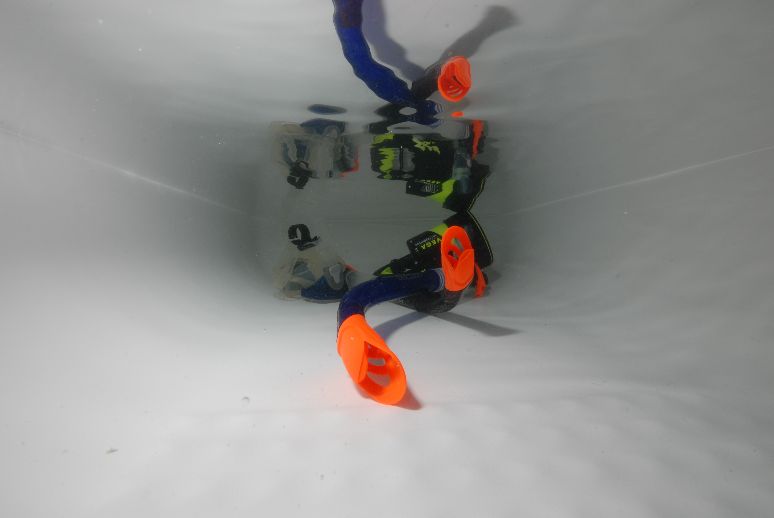

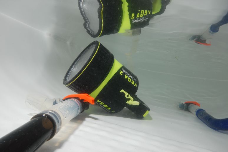

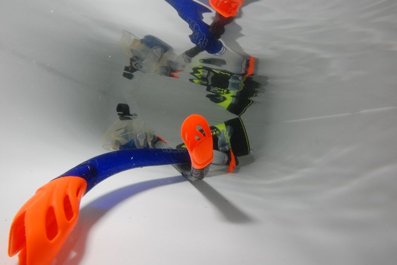

    I hope to try out my sigma 10-20mm wide angle lens and sea and sea nx compact dome with 40mm extension ring in open sea soon, but initially tried testing this combo in my bath tub last nite. The last two images were shot at f19 1/180sec with strobe at the 10mm end of the lens, the first image shot at the 20mm end of the lens at f16. Could anyone tell me what they think of these images as I havent a clue what I'm supposed to be looking for re: corner sharpness- or should I retest the lens conditions at different f stops.
    What I just wish to ask is- what do you think of these images??? Any critique/advice much appreciated.

  2. If you really want to see what's going on photograph a flat grid of some sort at different zoom settings and stepping through the f stops starting wide open.
  3. and it really helps to have some text or detail in the corners so you can see the results at the different f/stops.

  4. The flat white makes it very hard to tell what you have in the corners. You don't have to use a chart if you don't have one, but you need something with some detail at the edges.
