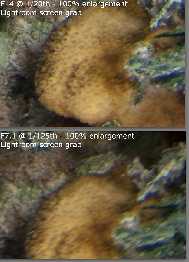

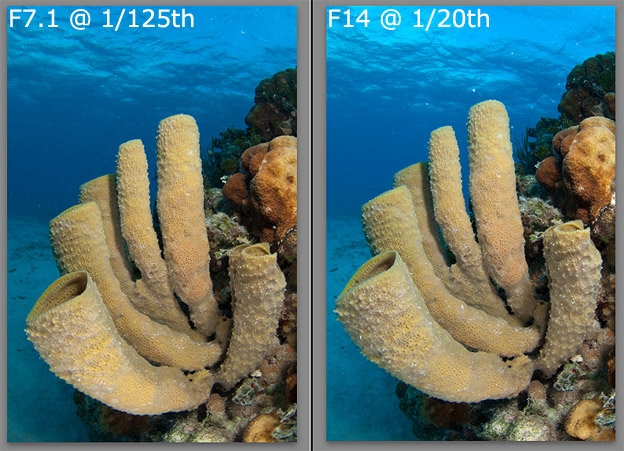

    Here are two test shots to show the corner sharpness issues associated with a small dome. These two images of the same subject are taken with D2X + 10-17mm @ 11mm (meant to use 10mm, but just did not wind it all the way), one at F7.1, one at F14 (this is a 2 stop difference).
    Here are corner enlargements to 100%, screen grabbed from Lightroom.
    At F7.1 corner sharpness is not acceptable to me. But stop down two stops (F14) and it is much improved, and while still not perfect is acceptable IMO.
    Of course at medium resolutions the F7.1. example looks fine and many may be content with this. After all soft corners to focus the attention on the subject.
    I also did pool tests, where I was able to compare the small and "normal" FE dome. From these I concluded that the corner sharpness difference between a big dome and small dome is about 1-2 stops (i.e. for the same corner sharpness as F8 on a large dome, you need to be at F13/F14 on the small dome). I much prefer real world tests, the flat tiles of pools are a bit artificial for evaluating what we might deem acceptable in a real shot, but I did not have the opportunity to repeat these in the field.
