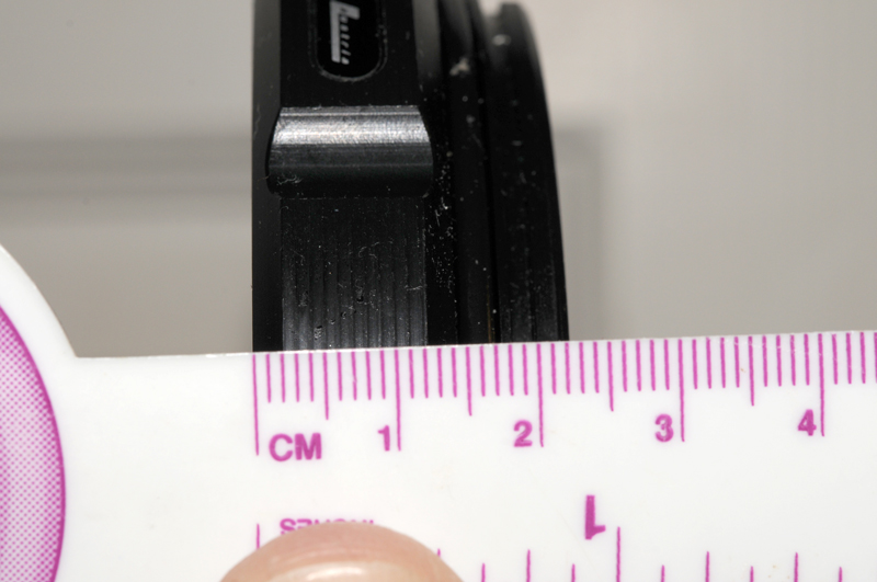

  6. Extension Ring 15 definitely doesn't vignette with the ND300 or ND30 housings (two models have actually be produced for D300), both have been tested pretty thoroughly by us and our customers. My first thought would be to measure your extension ring and make sure you have what you think you have, as both 18 and 20 vignette. They are easy to measure, just the measure the length of the knurled part you'd put your hand on when mounting.

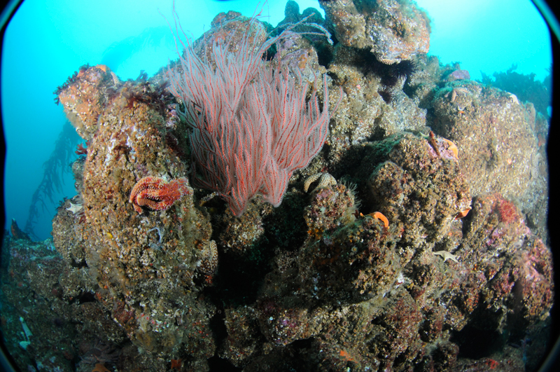

  7. This looks like vignetting to me.
    This looks like a 15 mm ext. ring.
    Has the combo of the 100mm Zen dome and 15 mm Subal ext. ring been test with the 3rd generation Subal mount?

  9. That definitely is vignetting, and that is a 15mm extension.
    We tested the combo with several Subal third generation combos, including D300 (both the ND30 and ND300 models I believe). I've sent a pm asking the housing serial number so we can look into this further.
