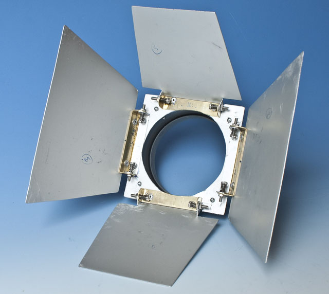

    I'm doing a lot of close up wide angle shooting in low viz, darkish water. Usually I use the edge lighting technique as described by Martin Edge, i.e. pulling the strobes way back and pointing them outwards. I made these barndoors so I can point both strobes towards the subject and control the beam angle -- hopefully eliminating hotspots and backscatter.

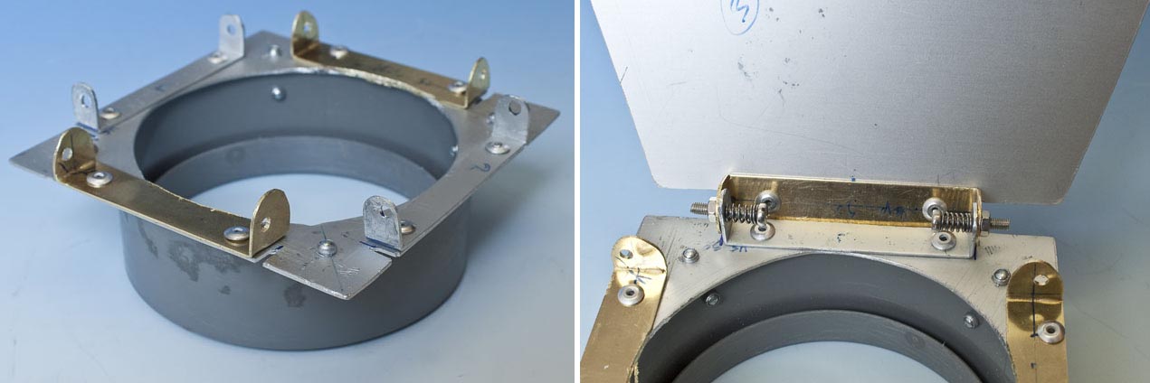

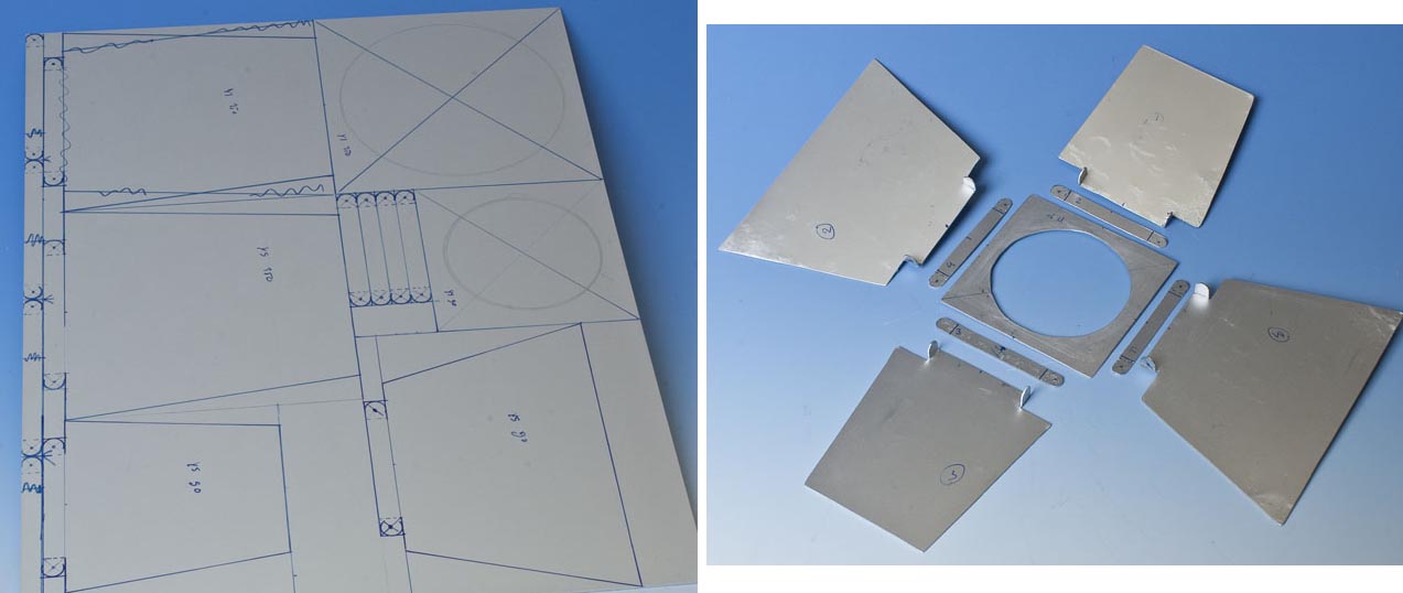

    I made two sets of barndoors. One for the Sea&Sea YS350 and one for the Sea&Sea YS90. Commercially available barndoors were too large and didn't look as if they would last long in salt water. I used sheet aluminium, brass strip, some standard plumbing stuff, a rivet gun and stainless steel nuts, bolts and springs. Here is how it looks:
    Some remarks:
    always protect your eyes when working with sheet metal (hey, we're photographers...)
    I cut the sheet metal with a razor saw. Round all corners with a file and sand the edges with coarse sandpaper
    The mount for the YS90 is a PVC adapter ring from the plumbing department. 8 cm diameter
    I didn't have to make a mount for the YS350 barndoors. I can stick them on the big rubber ring that is on the flash. 12 cm diameter.
    I will give them a try this Wednesday,
    (fingers crossed),
    --Rob

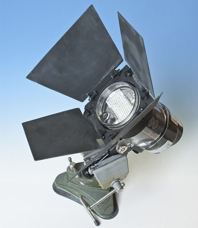

    I took the barndoors into the water yesterday, and here is what I learned:
    they cause an awful lot of drag when swimming in waters with even a wee bit of current.
    the YS 350 barndoors need a better solution to get them to stay on the flash. They were wobbly and fell off twice. I will probably rivet an aluminium ring to the back. The YS 90 barndoors were no problem at all.
    I need to increase the tension on the springs/screws to make sure that the doors stay put. In thin air they were fine, in the water they were all over the place. Maybe a rivet on one side and the spring/bolt on the other will do the trick.
