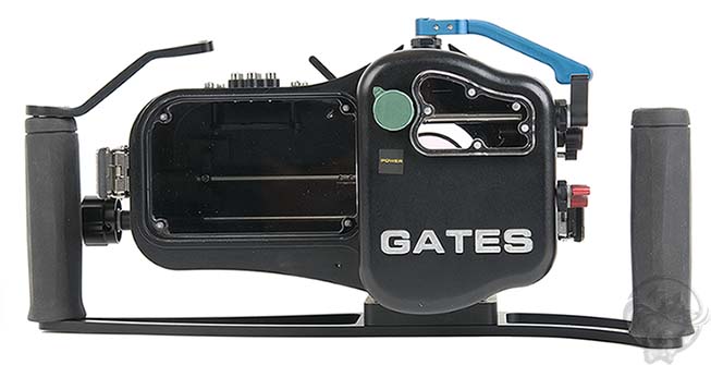

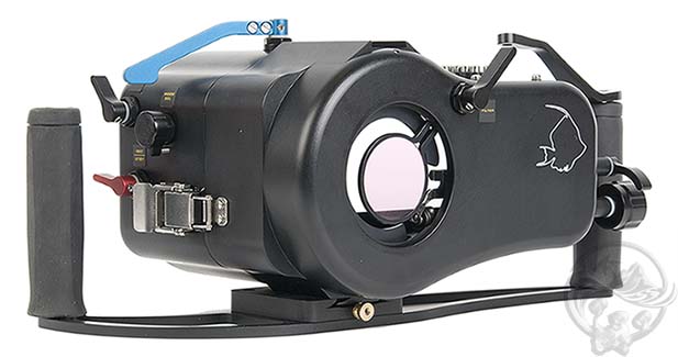

  1. We received our first batch of the new Gates HF S21 housings and WOW they are beauties!!! First and foremost, the nearly one inch larger LCD on the camera is VERY noticeable, and will make a huge difference for viewing underwater. Add to that the dual SDHC memory card slot, and this is a power house for the $$$. Personally, I bought the HF S20 model camera (housing supports the HF S200, S20, and S21 versions). With the dual memory slots I don't need the large hard drive, but having some built in memory is nice which is why I chose the 20 over the 200.

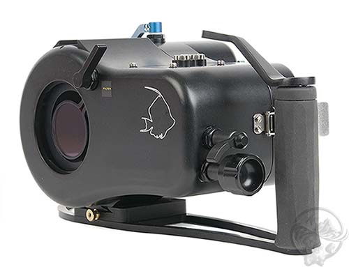

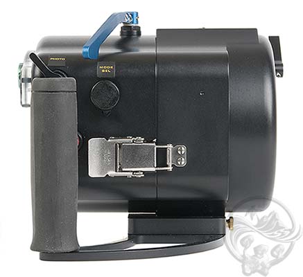

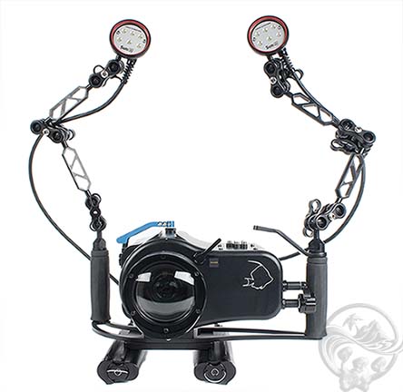

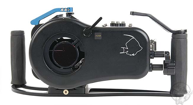

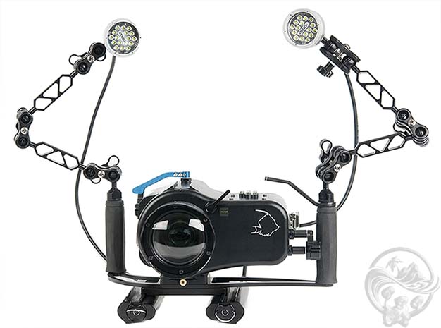

  3. yes I will repost them, Im waiting for the smaller sized photos from our photographer. I wrote it, tried uploaded and they were way too big. Should have them tonight so I can upload. We took some nice detail shots and put together some housings with different light sources

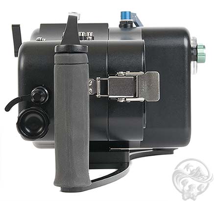

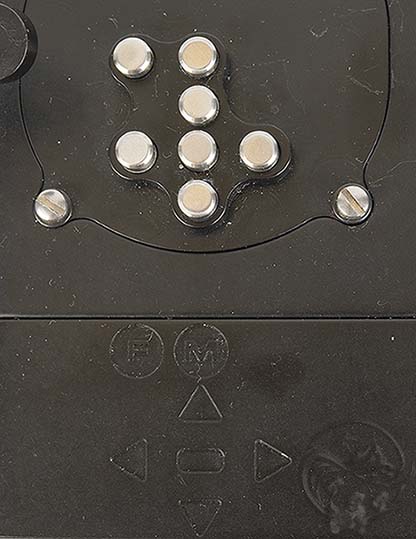

  4. Here they are resized, enjoy the pics!

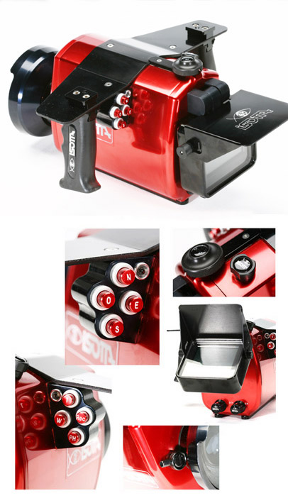

    Right now I'm using a wonderful italian housing (Isotecnic) for the HC7 and the external monitor is mounted behind the housing and can be rotated for the best viewing:

  13. Right now I'm using a wonderful italian housing (Isotecnic) for the HC7 and the external monitor is mounted behind the housing and can be rotated for the best viewing:

    Never opened one. They are magnetic command buttons which controls the camera through the remote/lanc interface. Never had a problem with them. We brought the housing several times a 100m. All the housing are rated for 150 mt and individaualy tested at 200m.
