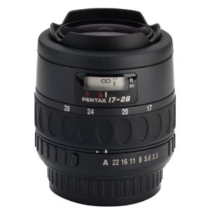

  15. There was once a SMCPF Fisheye Zoom 17-28mm f/3.5-4.5 made by Pentax for 35mm film cameras, unfortunately no one as decided to resurrect it.
