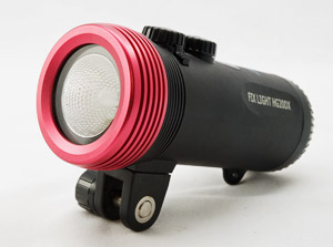

    Drew,
    Are we talking about the same light? I am not thinking of the beam from this light as being "narrow". Attached is a photo from the web.
  9. Tom, if I remember the beam from when I had one of those, it's less than 60° wide. Anything less than 90° is narrow to me. Perhaps I shouldn't have used the word "very" :)
    Even if you find the beam wide enough, the other points still stand. At 20W, you get about 400-450 lumens, probably less with a wider beam from that frosted bulb. Even 200W halogens have difficult lighting up anything more than 3ft away in daylight.
    Edited by Drew
  10. As a point of clarification, the HG20DX has a 90 degree beam.
    I think they are fine lights for macro video. I wouldn't filter them, I'd just white balance to them. I feel they are underpowered for mixed lighting situations.
