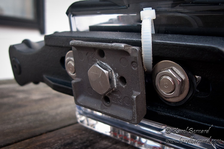

  5. Hi Cal!
    I'm not able to give You any hint on the camera selection, but I have some experience shooting panoramic images UW.
    I have used my Canon G9 for that and the results are not so bad.
    Firstly You do need a tripod for this - I dont think monipod is steady enough (but then again I havent tryed to use a monopod, so can't say for sure).
    I use manfrotto ballhead tripod and it works quite well.
    I have attached the tripod connection plate under my Ikelite housing handtray like this:
    Usually I take 3 to 10 portrate images and stich them together.
    Here are a few results as well:
    Hope this helps.
    Karel

    Also- thanks for housing pic. That really helps!
