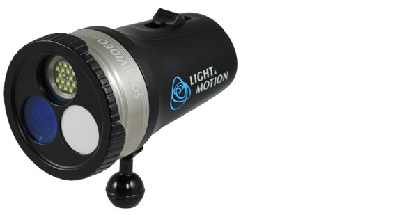

  1. I want to add just one video light for shooting video clips besides stills on my Nikon D3s on a Subal housing with 2 Subtronic Nova strobes. When being recently in the Maldives the pilot lights from the Subtronics were really not strong enough and hotspotting.
    Therefore I was thinking to add just one bright video lights on top of the housing using a short arm with 2 ball screws. I am currently using the new Nikon 16-35 /f4 VR II which has an zoom angle of 63 to 106 degrees. Right now I am looking at either
    - L&M Sola Video 1200
    - L&M Sola Video 4000 (newly announced, but still pretty unknown, supposed to come in April 2011)
    - Keldan LUNA 8 LA-V
    When I was in the Maldives during the last 2 weeks the divemaster and tour operator was using 2 Keldans on his video gear. It was pretty impressive how bright (2x2100 Lumen) , easy to use and robust-built these are. They give a 2 x 90 degree anlge through the diffusor and dome, 5000 Kelvin, 5 power settings, 2 x 0.14 Kg negative in water only, but at a steep pricing.
    On the other hand, the new Sola 4000 might be an even better alternative.
    Concering the Sola design (and I am assuming that the new sola 4000 will have a similar design characteristics like the 1200) I have a question which I could not figure out myself from the specs: is the lamp unit and/or the battery unit separable during air transportation? This is for me very important since here from Zurich airport they don't let you go anymore since 3 years if a diving lamp or a flashgun cannot be divided into an independent battery/energy and bulp unit. You even need to sign a document each time when flying that this is the case and that the passenger is committed not to assemble these items during the flight.
    Any suggestions in general for using just one video light, albeit bright (2100 Lumen if Keldan or 4000 Lumen if Sola 4000) instead of 2, but with a 90 degree beam angle for covering most of my actual lens?

    There are many good products available now and sorting though all the specs can get confusing. Also, every videographer / VidDSLR user has their own priority of requirements. As a VidDSLR user (the Panasonic GH1/hacked) I would list the features I'd look for as:
    1) Beam angle (120 - 90 degrees)...to cover a very wide angle lens that a VidDSLR can use.
    2) Lumen power output (2000 - 3000 Lumens) to provide enough light to take still photos as well as video. Also, when comparing Lumen ratings of different units it's important to equalize them in terms of considering stated Lumen power at the specified beam angle...i.e something that puts out 4000 Lumens @ 60 degrees is roughly equivalent (power wise) to 2000 Lumens @ 120 degrees.
    3) Size/weight vs power/burn time. Since the bulk of the weight is due to the battery pack size consider the minimum FULL power burn time you require for your purpose. Also consider air safety regulation implications of the battery pack technology a given design uses. The main battery types are NiMH; Lithium Ion and Lithium Polymer.

    Hi buddy,
    The Sola 4000 looks to be a pretty impressive piece of equipment. I got a chance to see it in person at DEMA. It's quite a bit bigger than the Sola 600/1200. The dimensions on the website show 57mm x101mm for the 600 series and 85mm x 143mm for the 4000. It's visually much bigger and may not be to goto answer for a still camera video light that you only plan to use occasionally. Recommend you get a good look before you plunk down the credit card. As always, it depends on how you plan to use it and your specific needs.
    Steve

  7. I suggest you read up on the Sola lights (and every other light!) before you make a decision:
    http://wetpixel.com/forums/index.php?showtopic=38589
    Unless your subject is 2-3 ft away from your lens, having one light, even one at 4k lumens, won't do much good for wide angle in bright ambient daylight conditions. Since you are using a D3s, then you are limited to almost auto video only, so an adjustable light is probably best to give you flexibility.A single light is compact but you lose flexibility with how you can play with the light and of course, if you are in turbid water, there's less ability to avoid backscatter.

  9. I'll comment that beam angle relative to your lens is critical. I've been playing with a fair few lights and building our own DIY ones. Without any optics/diffusers we're getting some very wide beam, but then using the Tokina lens a single light is not wide enough. This is what happens when you don't have a wide enough light, so select the appropriate angle for your needs.
    Test video with single ~1600 lumen head, ~120 degree beam with tokina 10-17 @ 17mm. http://vimeo.com/17779777
    another test dive with the tokina (as above) and L&M Sunray 1000 (single head) - http://damiensiviero.blip.tv/file/3382219/
    I've come to the conclusion that two heads are a must for my shooting requirements. On land it appears that one head will be enough, but I presume refraction or similar brings it in underwater and they're a fair bit narrower (anecdotally anyway - perhaps someone can offer science here).

  11. I've come to the conclusion that two heads are a must for my shooting requirements. On land it appears that one head will be enough, but I presume refraction or similar brings it in underwater and they're a fair bit narrower (anecdotally anyway - perhaps someone can offer science here).
    I completely agree. I always use two lights for several reasons:
    1) Makes life easier in terms of covering the total FOV of very wide lenses. Even a light with a very wide beam (say 120-90 degrees) will be a challenge to consistently align to cover the full area during a hectic shoot...particularly when moving in/out on the subject. The VidDSLR's I'm now using provide unheard-of wide angle FOV (for video) when used with a dome port. The 7-14mm LUMIX is about 114 degrees; the FOV of the LUMIX FISHEYE 8mm / F3.5 is diagonally 180-degrees.
    2) Two lights can be positioned to eliminate shadows for closer subjects...or they can be positioned to give some shadowing IF required. Thus greater flexibility of lighting control.
    3) Bring two lights close together and you will boost overall light intensity on the subject (but it won't necessarily be double intensity).
    4) I sometimes...actually quite often...take one light off and hand it to the "model" for certain scenes. This usually works even with a day-boat "allocated" dive buddy who might not want to carry a light around for the full duration of a dive.
    5) Two lights...especially if they are of a larger design...can actually help improve the stability of a relatively un-ergonomic VidDSLR type housing for video work.
    6) Fantastic coverage at night! :P
