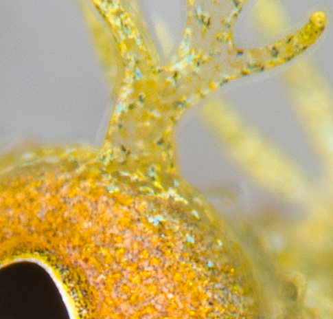

  1. I took these test shots yesterday with the FITpro external dioptres. They are dual element, underwater close-up lenses that come in +5 and +8 powers. Although they are at the cheaper end of the scale, I have been impressed with their sharpness, but more so with their lack of fringing and other optical aberrations that can effect corners in this sort of setup.
    These shots are all with Nikon D7000 and 105mm VR and 1.4x teleconverter (all on minimum focus, all uncropped). So they are already at high magnification before the addition of the dioptres (dioptre used noted on image). They are close up details on the small polyps of star coral (each polyp is approximately 1-3mm across).
    But I thought I'd share these tests - as I actually managed the photograph the same polyps with each setup!
    If you want a general purpose close-up lens then I'd favour the +5. Whereas if you want something for super-macro to use in conjunction with a macro lens and teleconverter then I'd go for the +8.
    They do work stacked together - but Depth of Field is razor thin and only suited to certain subjects.
    Alex
    p.s. There are many, many external dioptres on the market. I was lent these for my trip - and had not seen any test shots from them before - so thought was worth sharing.

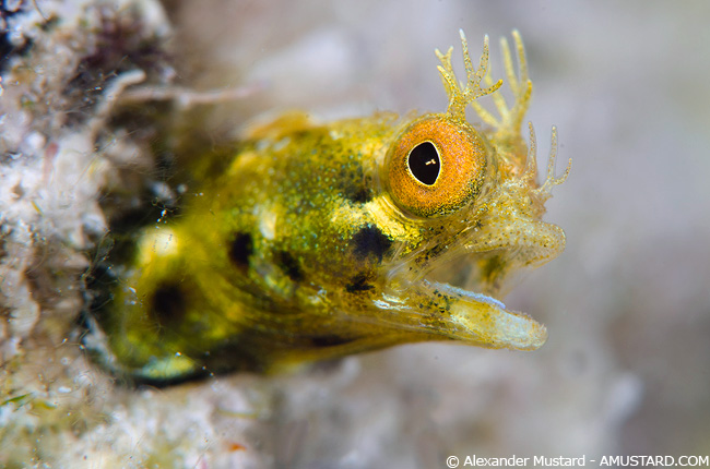

  7. I have shot these a lot more now and I'm very impressed with the image quality. This rough head blenny is taken with the +5 and +8 dioptres stacked together and in front of a 105mm VR and 1.4x teleconverter - on minimum focus (for those who have not dived the Caribbean, like pygmy seahorses, rough heads are much smaller than people expect).
    Whole frame:
    100% crop (straight export from lightroom - not sharpened):
    This is really impressive detail and very well controlled fringing (no CA or other corrections applied in RAW conversion), considering it is with stacked dioptres.
    Alex

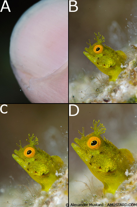

  11. We went out again yesterday afternoon to photograph the golden blennies on the workshop - and many people were really shocked by how small they were - so I shot a sequence again - as this gives a better idea of the performance of the external lenses and performance we're discussing.
    A - my fingernail taken at minimum focus with Nikon D7000 + 1.7x TC + 105mm VR (no external dioptres).
    B - blenny taken at minimum focus with Nikon D7000 + 1.7x TC + 105mm VR (no external dioptres).
    C - blenny taken at minimum focus with Nikon D7000 + 1.7x TC + 105mm VR and FIT + 5 diopter.
    D - blenny taken at minimum focus with Nikon D7000 + 1.7x TC + 105mm VR and stacked +5 and +8 diopters.
    All images are uncropped:
    Alex
  12. Very great pictures and test
    What is the distance to the blenny to take this pictures ?

  18. I have shot these a lot more now and I'm very impressed with the image quality. This rough head blenny is taken with the +5 and +8 dioptres stacked together and in front of a 105mm VR and 1.4x teleconverter - on minimum focus (for those who have not dived the Caribbean, like pygmy seahorses, rough heads are much smaller than people expect).
    Whole frame:
    Alex
    Great shot Alex!!
