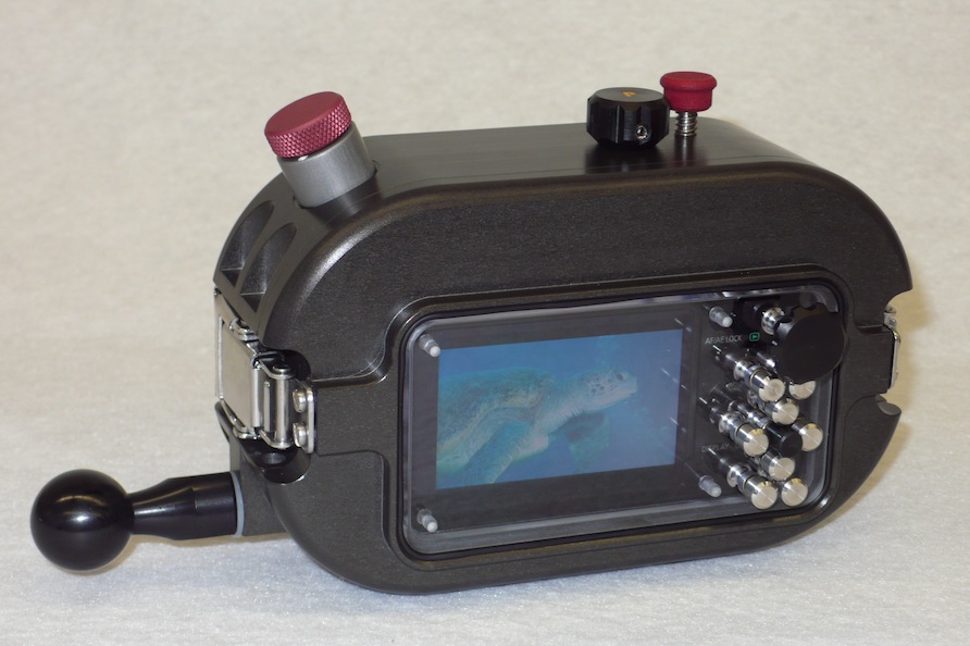

  16. Attached is a picture of the back of the UK Germany Housing ... One can put a flat or dome or port on it.
    Edited by allen

  18. Don,
    To my knowledge no one in the USA stocks UK-Germany housings. I got mine from a very good dealer in Germany, Stefan Horvath at http://www.uw-fotopartner.de. The cost is € 920 without VAT. Further, there is no duty on the housing. In fact, I got my housing, strobe, tray, etc all sans duty. It probably helped that I saved sometime by chatting with a customs official a head of time and had the customs numbers on the invoice.
    According to my note this morning from Uwe the housing is currently in production as he had to make very few changes from the previous version.
    A few comments about the housing. It is compact but heavy in the water. The camera fits into it like a glove, it does not use a tray or other screws to hold it into place. Though there are soft tabs. The flash is not accessible, everything is via the hot shoe and sync cord (Nikonous 5 pin).
    Hope that helps.
    Allen
