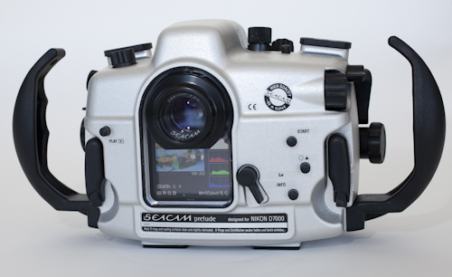

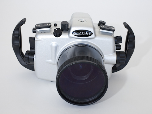

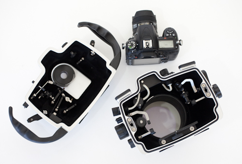

  6. Kind of late for this discussion, I realize, but we had a SEACAM Prelude for D7000 passing through the studio yesterday on its way to new owner and I grabbed these product shots. Not even the right lens for the macro port, but its what we had on hand at the time in the Nikon realm.
    SEACAM has updated their site with some very nice D7000 studio shots - see:
    http://seacam.com/en/products/housings/nikon/d7000
