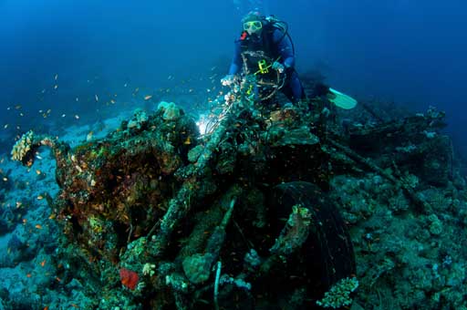

  1. I have always got more out of looking at other peoples' images than anything else on Wetpixel, so, since the Image Improvement Center seems to be a bit sluggish, I'd like to start a thread on pictures that almost work, but not quite...
    Toyota pick-up, Sha'ab Suedi, Sudanese Red Sea
    I think that the lighting could be improved, but I'm not sure what to change.
    Tim
  2. Hi Tim,
    Good idea. You re right image improvement forum is a great place to learn more...
    For this hmmmm
    1) There is no focal point because the truck is a little indistinct. I have tried these sorts of shoots before and have had the same issue. Instead of trying to get the whole indistinct shape in I tried to find a part of the truck that was identifiable, a wheel, radiator, steering wheel. I found doing this I was a little happier with my images (will try and dig them out to post).
    2) Balance is a little off. I think my eye would be happy if the diver where of to the right..
    Just my thoughts and lets face it whom am I to say :)
    Erol
  3. Agreed - but who am I also.
    Nice but there's just too much in it for me. A crop, portrait with the diver top right and the steering column coming diagonally through the frame might have more impact.
    The tyre is nice though, maybe the camera should have been positioned a little further right to make this crop/composition work.
    2c
    Tim.
    Edited by Balrog
  4. Well...
    ... the subject is "diver and car", the technique was to use a slave strobe to put detail on the diver and yet be able to show the context, the whole engine and particularly the front wheel. The point was not to create a typical " bit of wreckage" image. A version with the diver to the right looks unbalanced to me, because the wreckage to the rear is cut off...
    ... hard, isn't it? I agree that a portrait version based on the steering column would have been a good idea, but my buddy swam off to the next vehicle before I thought of that!
    Tim
  5. Yes, it's easy when you get in front of a computer on dry land :) - by which time it's too late

  7. I have always got more out of looking at other peoples' images than anything else on Wetpixel, so, since the Image Improvement Center seems to be a bit sluggish, I'd like to start a thread on pictures that almost work, but not quite...
    Tim
    I think I'm nobody to give critics here, but as the main subject here is an exercise of what can be improved, here are my thoughts:
    - We can clearly see the light of the slave strobe in the palm of the diver, he blocked a portion of the light. Maybe a different position of the slave strove might help to illuminate the diver a little more.
    - It could be better if the slave strove was hidden from the camera, less distracting and more natural.
    - And finally I think that the wheel needs a little more light.
    Just my two cents.
  8. Framing is a bit tight with the tyre being cut off and the diver cramped for room at the top.
    Maybe a lower viewpoint looking up more would help, with more light on the tyre or some recognisable subject in the foreground.
  9. Maybe a lower viewpoint looking up more would help, with more light on the tyre or some recognisable subject in the foreground.
    I was hovering just above the sea bed, looking into a 45-degree viewfinder: I suppose that I could have dug a hole...
    ... I'm getting the feeling that it's a set-up that was never going to work because the corroding Toyota is too flat and too wide to frame well, the tyre too dark to light without distracting from the diver and an off-camera strobe fired by its own sensor will always risk appearing in the frame.
    Conclusions:
    1) Use an Inon Z-240 with a remote sensor on a cable to tuck the off-camera strobe out of sight.
    2) Choose a subject that can be framed vertically.
    3) Choose a subject with a colourful foreground.
    4) Buy better eyes, so that I can see the flaws in the review image!
    Oh, and the price for comments: you owe Wetpixel a view of one of your own less-than-perfect images! Fair's fair, you know...
    Tim

  11. Two aspects here; the technical aspects as everyone has discussed above, and the subject matter.
    I don't think there's anything you can do to make this piece of wreckage interesting, so the image fails before you even start. Unfortunately there's not much interesting about an amorphous piece of a Toyota pickup.
    The only way to make this more interesting may have been to make it an image about the model, getting closer in on the model possibly examining the wreckage.
    Edited by loftus
  12. I don't think there's anything you can do to make this piece of wreckage interesting...
    I think that you're right, but this is, for the same reason that wreck divers like toilets, a "classic" of the Sudanese dive scene and worse images have been published to illustrate diving at Sha'ab Suedi!
    Now, since you've responded, post your clunker, please?
    Tim
    Edited by tdpriest
