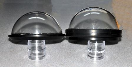

    Yes we have a good mini dome for the D700 + Sigma 15mm FE. Take a look at the links below for more information. I also wanted to clarify that the dome we make for the Tokina 10-17 is a different dome than the one we make for the sigma 15mm ad the focal point / entrance pupil is different for these two lenses. Canon EF 15mm f/2.8 Fisheye lens or the Sigma 15mm Fisheye on the left and Tokina 10-17 Fisheye lens or the Nikon 16 mm F2.8 AF lens on the right.

    Since you had mentioned that Alex Mustard had some problems with the Sigma 15 and his Subal D700, I re-read his “Thoughts on Mini Domes”. The backing plate of the UnderWater Camera Stuff Modular 5” Dome for the Sigma 15mm has been designed to eliminate the problems he described. When compared to the backing plate of the Tokina 10-17 Modular 5” Dome, you can see that the Sigma 15mm backing plate has been (using Alex’s words) “machined away to work”. The picture I posted in an earlier reply shows the difference in the backing plates.
    As I said earlier, I do have a blemished dome that I could loan you for evaluation. However, with a shipping costs of $40 in each direction, it seems cost-prohibitive and not a good option. We will be starting a new production run of the Sigma 15mm domes soon and I could hold one for you from the batch. I am confident the dome will perform well with your system but, if you discover any issues once you use the dome, I will work with you to reach an acceptable resolution.

    The "backing plate" is the back part (the black) of the dome shown below. The Canon EF 15mm f/2.8 Fisheye lens / Sigma 15mm Fisheye on the left. The Tokina 10-17 Fisheye lens or the Nikon 16 mm F2.8 AF lens on the right.
